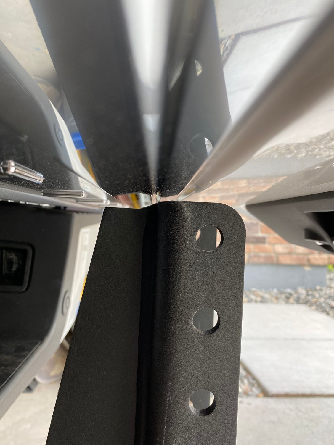

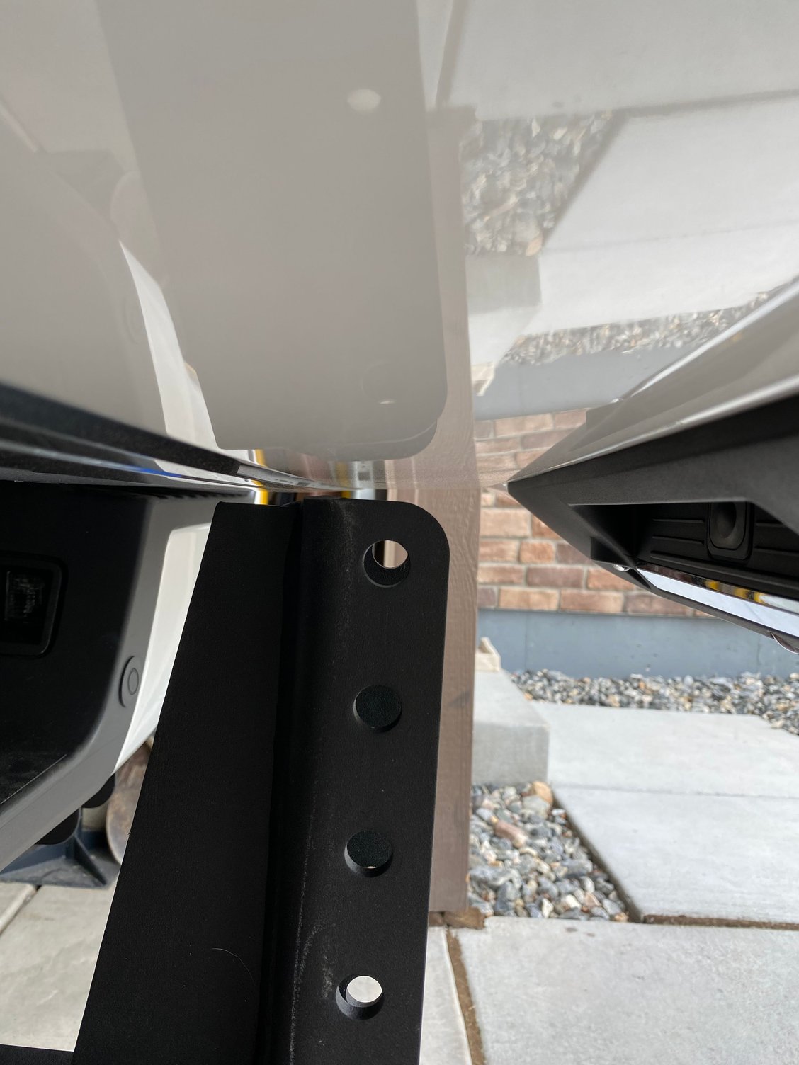

i forgot to post them 🙁 this is the Bulletproof 3” shank HD 8” drop/rise. Distance to ground isnt a factor as I could raise hitch using the air bags. I decided to exchange it for the 6” as that will get me the 30-32 height for the RV
The 8” just clears the tailgate but too close for comfort another reason for the 6”. Now with the 6” and WD adapter and Equalizer it will still touch the black plastic teim but I am going to add a foam guard or something

Thank you Squirrel, exactly what I was looking for. I have an F350 dually on order and I’m wondering what the height is from the receiver to the ground but I’ve always been thinking the 6” should be enough. The 29TRX is likely the same height or maybe higher than yours due to the wider/thicker toy hauler frame. Pretty sure I read they sit around 35” so I may need the 8” drop/rise.

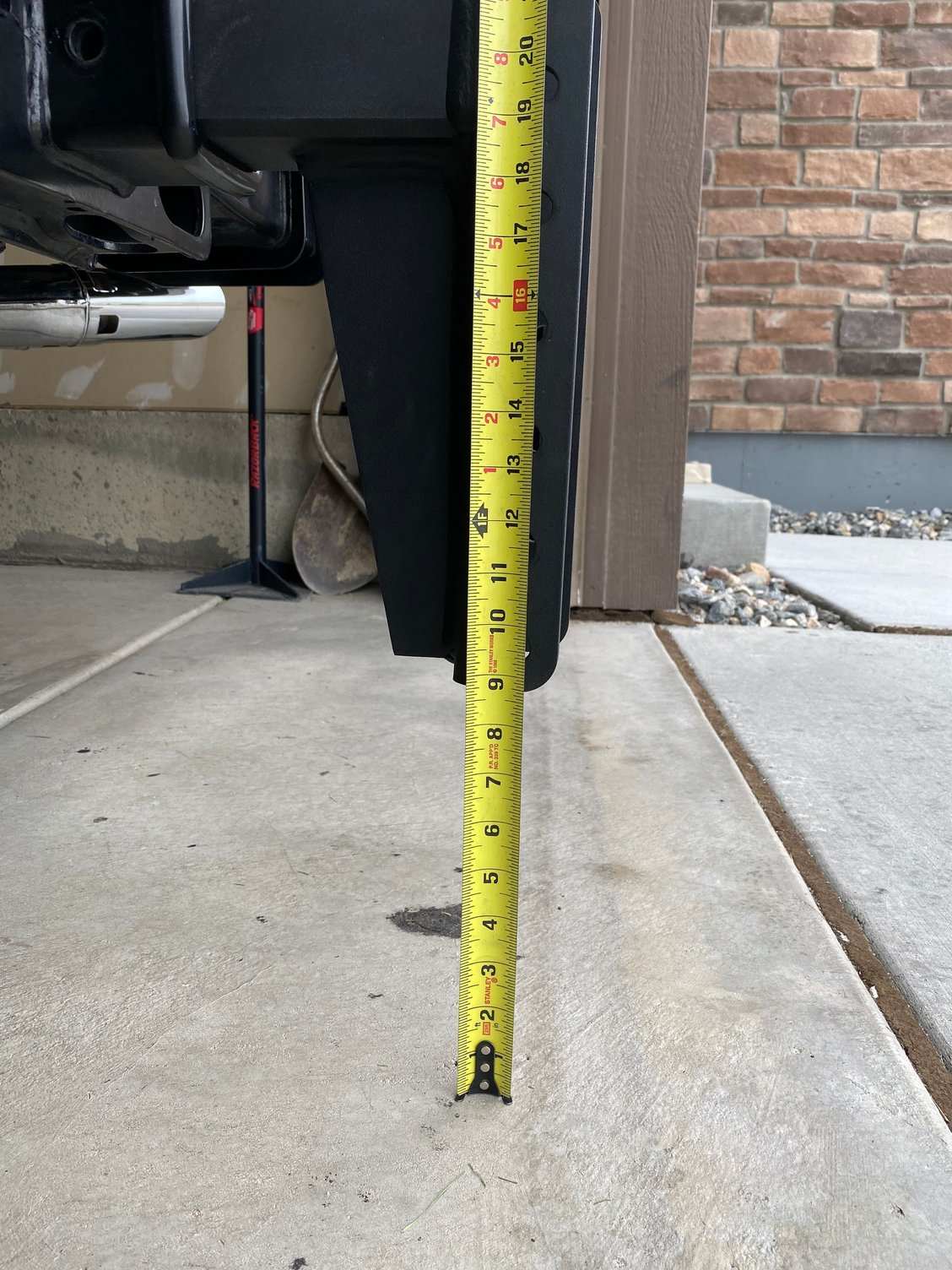

I contemplated between the 6" and 8" and ultimately decided on the 6". On my lowest trailer (16' utility for the rzr) the front is 18.5" off the ground and rear 17" so it is 1.5" off from being perfectly level. I thought it was pretty level by the eye so I had to pull out the tape measure. My ground clearance is 11 5/8" from the bottom of the ball on the hitch on the 6".
With the 8" I think I would have worried more about dragging it on the ground much more often. Even at the driveway of one of the cabins we regular my 6" will hit the ground if I don't hit the angle right. But this wouldn't really be a worry if you are mostly on flat pavement.
