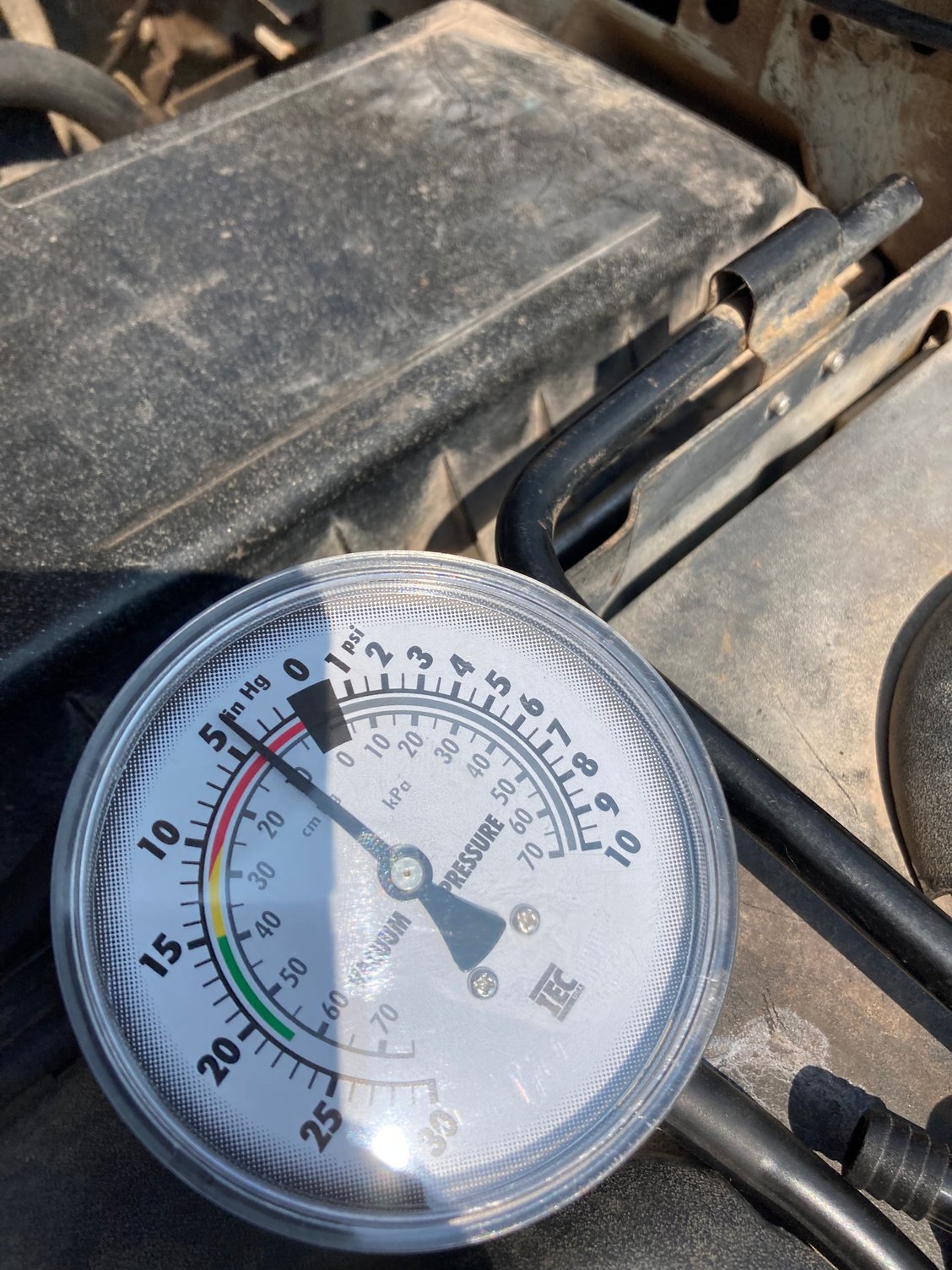

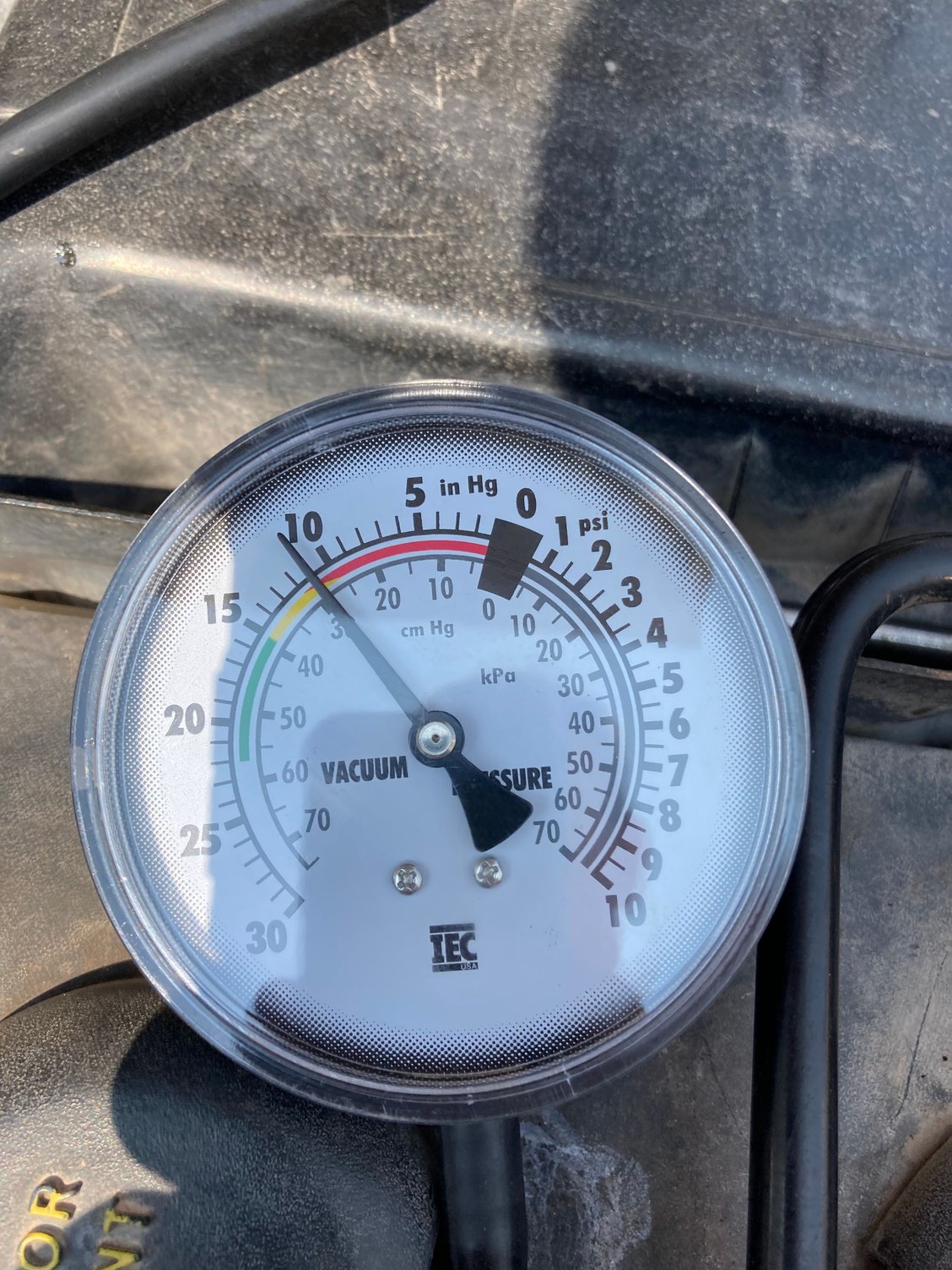

Hello again. So I ran the vaccum test and the piks below show the results at idle and at over 2000 rpms. I read that it could indicate a problem with the exhaust system since I got lower readings at higher rpms? I also got a code reader and the only I code I received was code 11 indicating every was ok. I realize the readings at idle should be higher.
The truck was running great until I went four-wheeling and I was hitting some huge boulders… And it did start running really bad right after that. I noticed that the shield that covers the catalytic converter was bent really bad. Didn’t notice a hole or anything. Tapped it with a hammer and I couldn’t hear anything loose? Is it possible that hitting the converter/exhaust caused a blockage and that is the problem? Thank you
After further reading,i took out the O2 sensor from the front of the converter, and it ran much better and had better vaccum(15-16) at idle. But once I checked it at higher rpms, it got lower than when the sensor was in(9-10). When I floored it it went down to almost zero.

Thank you. Yes that is where it is. I took it out and the engine ran better (15-16) at idle but it was still only (9-10) at 2000 rpms. When I floored it, the vaccum went down to almost zero.
With O2 sensor out at 2000+ RPM.
With O2 sensor out at idle. I’m at 4800 ft

Vacuum will drop as you increase engine RPM, that is normal.
The O2 sensor only works after the engine is at warm running operating conditions.
Do you notice a difference will driving with O2 sensor plugged in vs not plugged in?
Does the engine run well first 5 minutes from being cold start up in morning, vs running worse after being warmed up?
