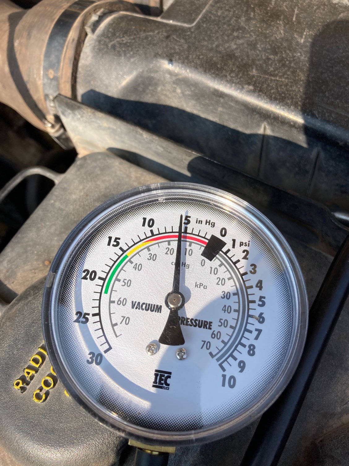

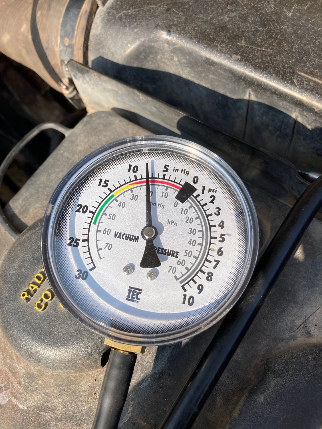

Hello again. So I ran the vaccum test and the piks below show the results at idle and at over 2000 rpms. I read that it could indicate a problem with the exhaust system since I got lower readings at higher rpms? I also got a code reader and the only I code I received was code 11 indicating every was ok. I realize the readings at idle should be higher.
The truck was running great until I went four-wheeling and I was hitting some huge boulders… And it did start running really bad right after that. I noticed that the shield that covers the catalytic converter was bent really bad. Didn’t notice a hole or anything. Tapped it with a hammer and I couldn’t hear anything loose? Is it possible that hitting the converter/exhaust caused a blockage and that is the problem? Thank you
After further reading,i took out the O2 sensor from the front of the converter, and it ran much better and had better vaccum(15-16) at idle. But once I checked it at higher rpms, it got lower than when the sensor was in(9-10). When I floored it it went down to almost zero. But the engine stills shakes really bad. Checked the motor mounts and they are good. Also if I turn the a/c on the truck won’t staying running without reving up the engine.
Test at over 2000 rpms. Based on what I read this could indicated a clogged converter or exhaust
Test at idle. I’m at 4800 ft. It fluctuated from 13-15
Possible yes.
I would think maybe you damaged the O2 sensor.
​​​​​​​I think it is mounted right in the center of the exhaust y-pipe, right in front of the catalytic converter.
