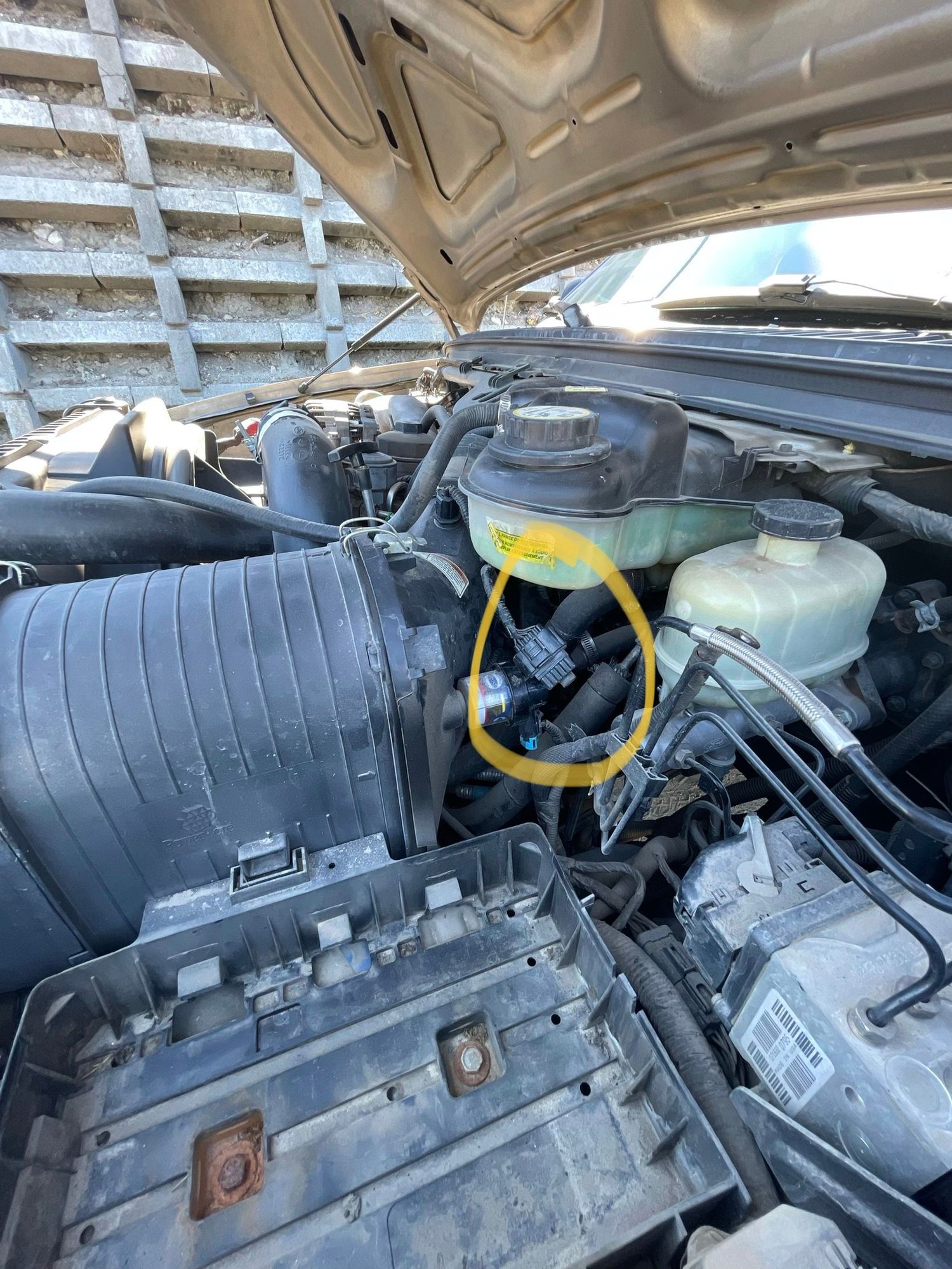

Was changing out my battery and noticed a loose wire. I can’t find anything in the nearby area that would accommodate this wire, can anyone prove direction?

That must be an 05 engine. That plug was for the MAF sensor, and it was eliminated on some 05's.
