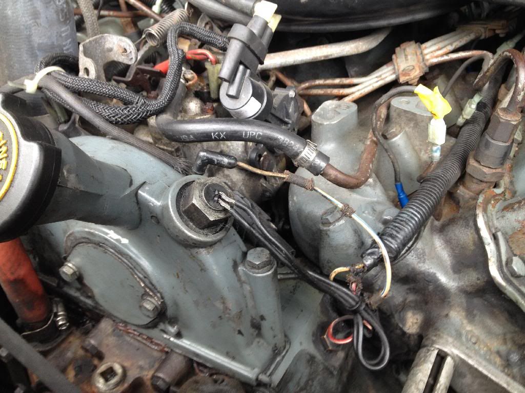

Also I have this mystery wire that's yellow and blue. Anybody know what or where it goes? And then there is two exposed wires that I'm not to sure about??
Old Apr 7, 2014 | 10:16 PM
88beast's Avatar
88beast
Joined: Sep 2007
Posts: 662
the yellow and blue looks like the water temp its on the flat sloped part of the block in front of the head. and the exposed are the tach sensor, only available from ford about 60 bucks
