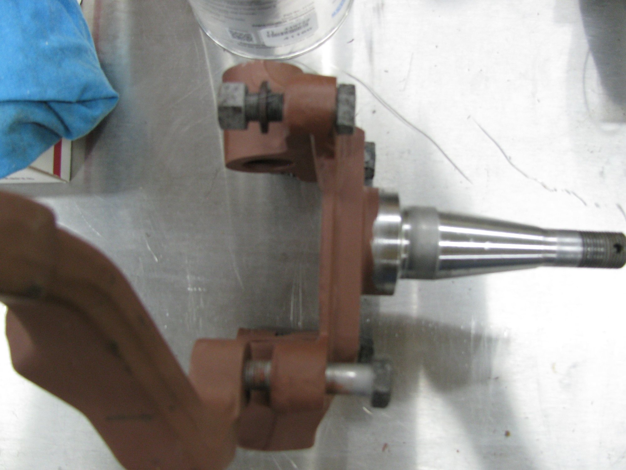

Is it possible the spindles are on upside down?
