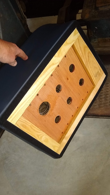

Fashioned new seat bases with the help of expert 32 Ford friend David R. Snyder's custom seat springs added.

Seats covered in Tuxedo Blue fit perfectly in the 32:
