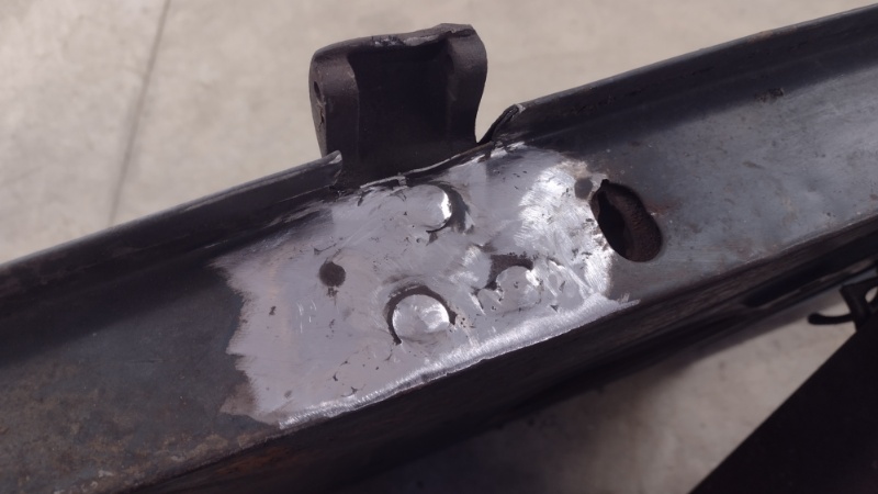

Repaired cracks (Mig welded) at lower hinge area:
