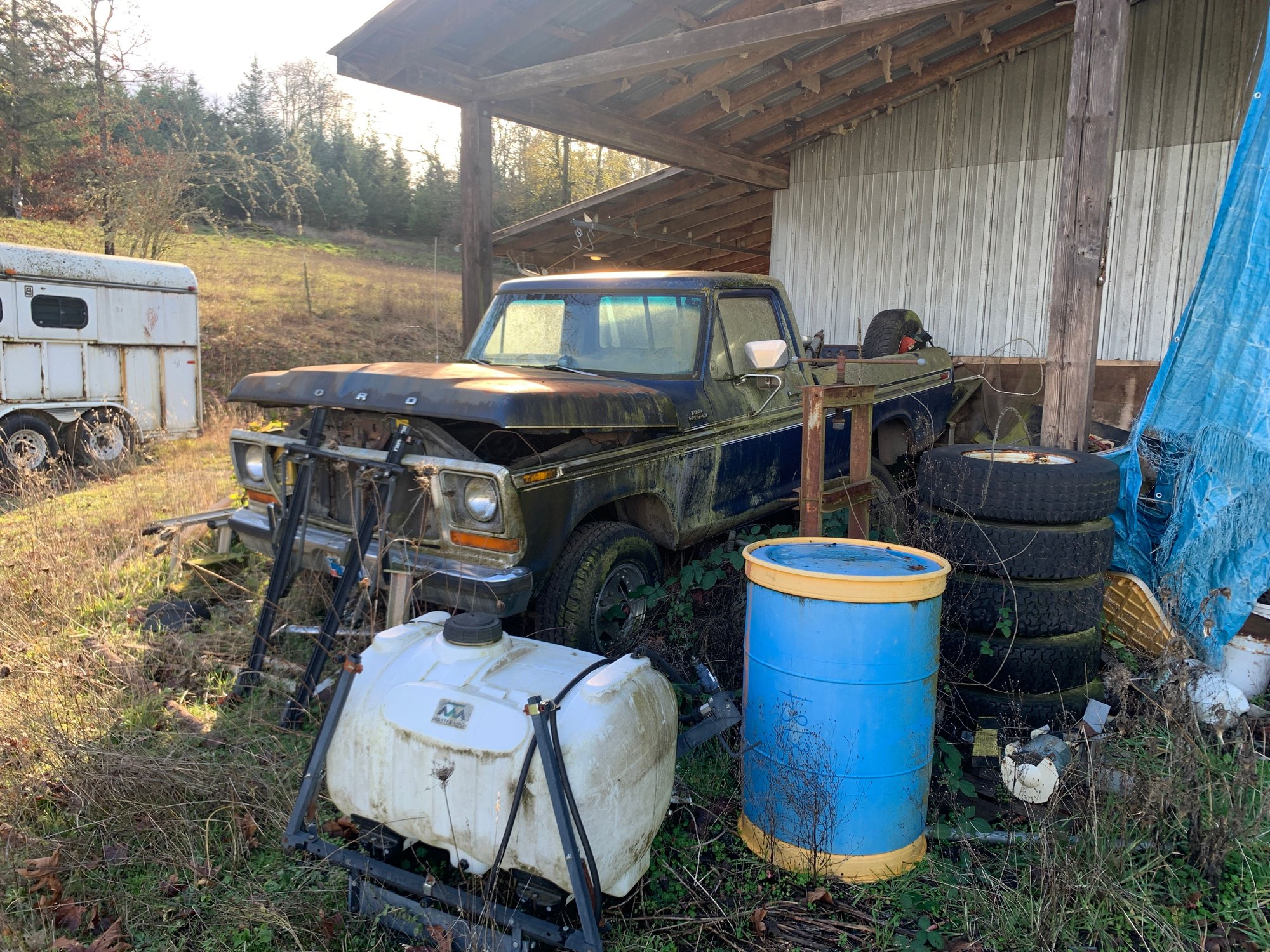

78 f150 4x4 with a 300 and a 4-speed manual (not sure which one) the 400 would come in from a 79 bronco that’s was wrecked long ago and is sitting next to the f150. It has a 400 that was rebuilt by a fellow named Everett Hatch before being put in the bronco and grandpa always said it was an impressive engine compared to what he knew about 400’s.
There is a blend of emotional connection (mainly to the frame and body of the f150) but also totally willing to modify and upgrade because the truck is no where near operable condition and if I’m doing so much work I might as well improve some things.
I figured I’d pick a trans after having the motor decided. Because of bell housings. Also I’m not a Chevy guy at all. Didn’t know they all had the same bolt pattern. If I stick with the 400 a zf5 conversion sounded really cool to have an OD gear.
as you can probably tell I’m not intimately familiar with all this and what ever I do I have tons of research ahead of me. This is just kind of helping me guide the direction I should be looking I suppose. Thanks.
EDIT: added pic of truck for fun.

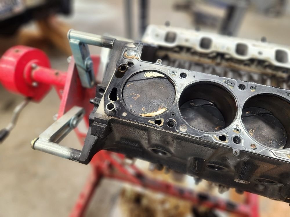

5000 mile update
Hello all,
Chasing a rear main leak thanks to my machine shop i pulled the motor and had to tear it down.
Attached is a picture of the piston. This is 100% what you do not want.. I am glad i did not sell the motor to anyone,, Now that i know i wouldn't sleep well.
The piston design leaves the step ~.120" away from the machined surface of the head. The flame front is not burning complete in this area leaving a lot of carbon soot behind. THe soot then encourages even more detonation..
If anyone want these pistons PM me,, you can have them. Not sure I would recommend them even for free but if not they will go to scrap.
Chris
