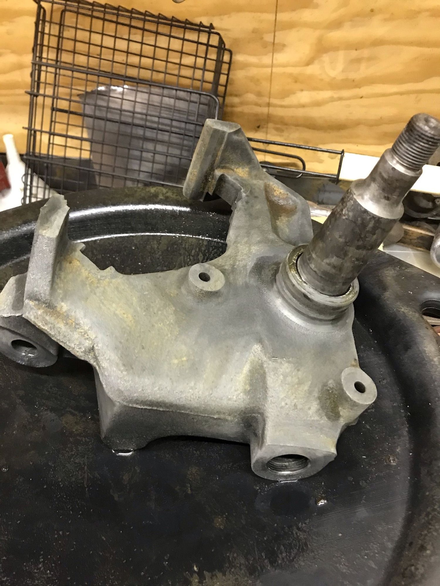

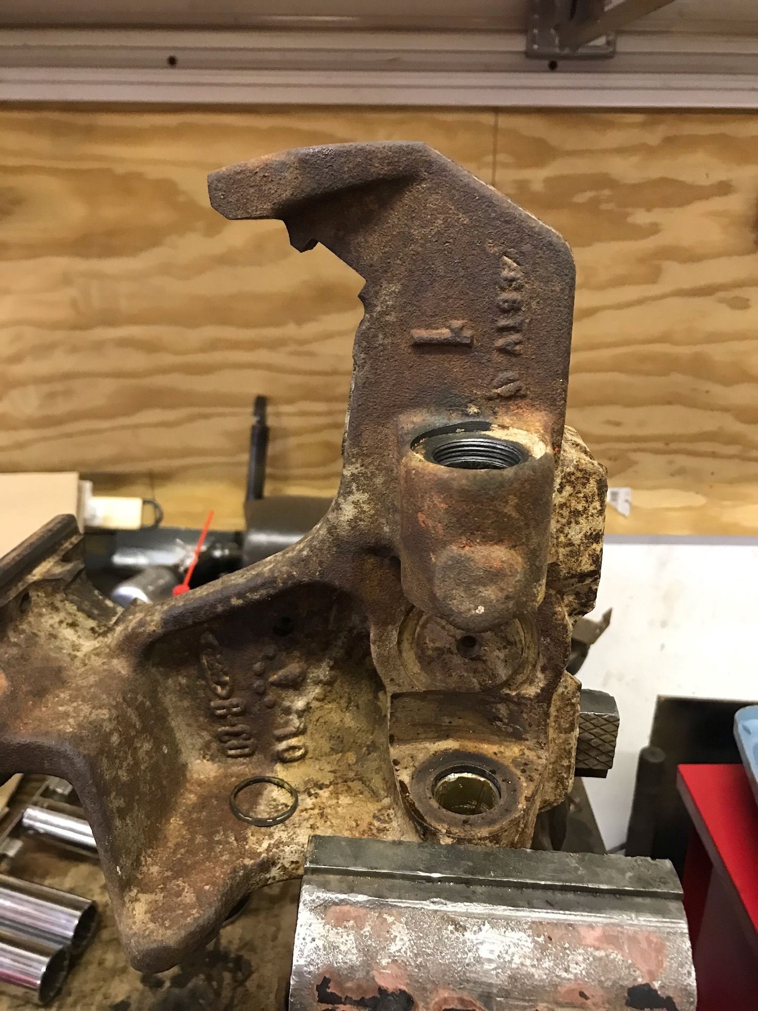

I picked up 5 gallons of evapo rust, a stick of 6” pvc and caps from Lowe’s to submerge the I beams in, of course the spindles too. Everything turned out great. Just a thought….

before and after…
