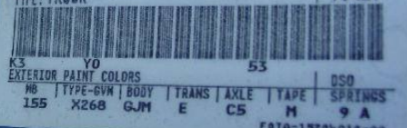

what motor, 2wd, 4wd, what is trans code on driver door jamb

It is a 302 4wd. I am out of town and can't look at the door jam at the moment.
