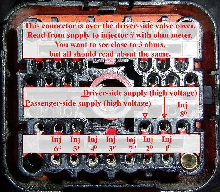

Recommend checking wiring from the 42 pin connector next - see if you get around 3 ohms for each of the injectors . If good, I'd do the same check from the IDM connector. If that is good, it might be time to find another IDM. A bad injector solenoid can shut down a bank too. Not sure how/if that shows up when ohming the injectors.
42 pin connector pinout:
IDM connector pinout:

I checked the 42 pin connector: placing one lead on the Driver’s side supply +
the other lead to:
inj 2 = 4.1
inj 4 = 3.6
inj 6 = 3.7
inj 8 = 4.9
lead to passenger side supply + the other lead to:
inj 1= 2.8
inj 3 = 2.8
inj 5 = 2.8
inj 7 = 2.8
-I’m still trying to locate the idm to test the plug on that....will post once found👍

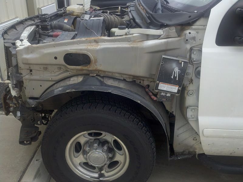

The IDM can be found attached to the inside of the driver side fender above the wheel well liner and toward the cab.

Ouch! Dang, does the fender have to come off or is it also accessible by taking the inside fender out?

It's accessible through the fender liner - this was just a handy photo showing location.
If the wiring to the IDM checks good, I'd suspect IDM or one or more bad injector solenoids shutting down the bank. I'm not sure which to point you to. Hoping some experts here will chime in. Not sure what to make of the difference in resistance on the driver's side bank vs passenger side.

Those passenger side test results are making my sciencey senses tingle. Same exact result 4 times? Nah brah.
Before spending on a new IDM I'd recommend pinging aka continuity testing the injector and common wires from the 42 pin connector to the VC connector, see wire #s HERE. Then either back from 42 pin to IDM, or under the VCs.
