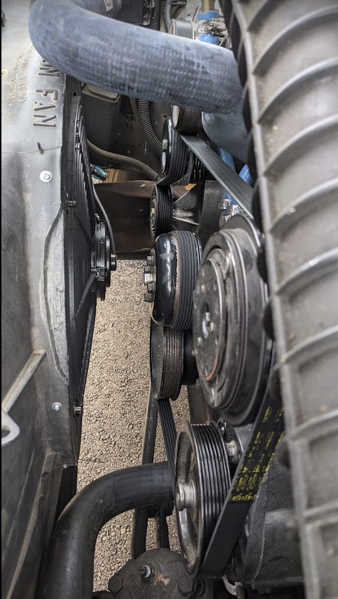

Mikulh, can you take a picture of it and post it?

Sure. I'll snap one tonight and post it tomorrow.
Here's a picture of my fan, mounted in my 6-cylinder fan shroud. This is my daily driver and I've no issues with overheating. My temp gauge stays around the "O" in normal, which is around 200 degrees according to my PimpX ECU.
I mounted it to the shroud in similar fashion to how Scndsin mounted his, except I cut a ring of wood to fill in the gap between the fan and the shroud and to force it to suck air across the entire surface of the radiator.
