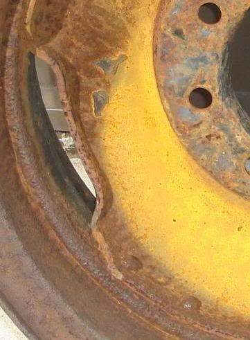

Widowmakers or not?
There is no split in the rim, no rings.
Outer rim solid, with inner rim riveted.
Just got my F3 flatbed running. Now I need tires.

Widowmaker.

Oh gosh, how to say it in a short paragraph? An example - a guy I sold a set of 19.5s to years ago told me that he had just bought an F-4. As he was winching it onto his trailer an inner dual let go. First thing he did was buy wheels. There are stories like that all over the web.
Back in the 1970s the federal NHTSA and insurance industry had a recall of them advancing through the stages of approval. The one good thing that came from the effort was industry agreed to stop producing them in 1972. Ultimately the lobbiests won and the recall failed, but the service industry, and court rulings, have pretty much eliminated them from usage. Stu

The center disc stays, and the side ring leaves. If the wheel is a SRW or an inner DRW, the side ring is trapped around the axle. An outer DRW is the killer. In the early days it was the service techs that got the worst of them. Cages helped, but they still come apart while in service. Stu
