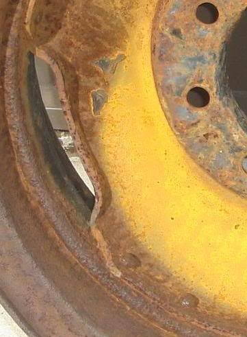

Look for this on the back side. The center disc is riveted to the widow maker joint. There were no one piece 17” wheels back then. Stu

Very dangerous to use and work on. Not worth sticking money into new tires for them. Much better off addressing the problem now than later and spending more money but it's your truck but please don't park the truck near anyone else.
