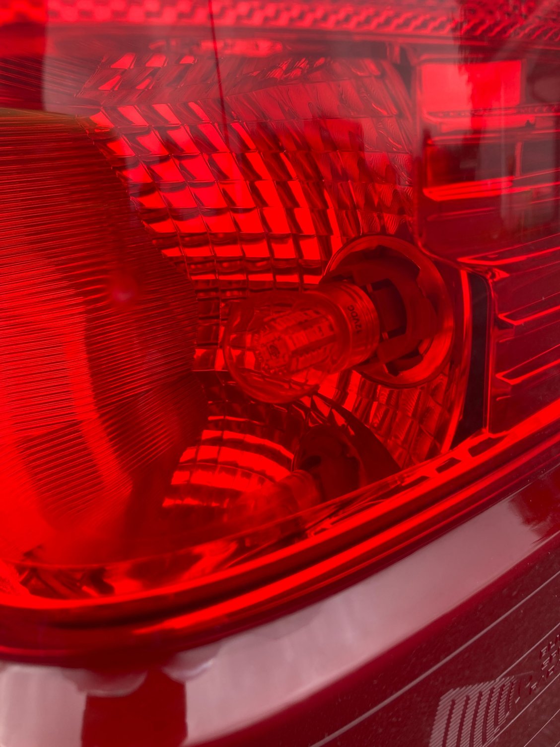

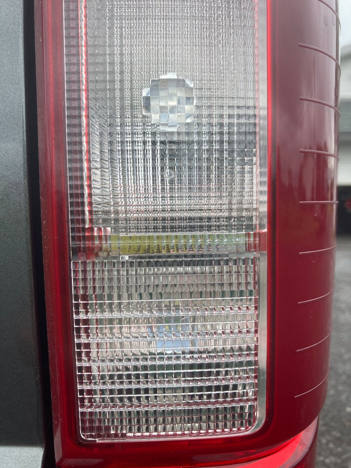

Originally Posted by Bis
The only caveat is, if your truck has Blind Spot Monitoring, don't buy the rear turn signals. You will already have LED turn signals. I sent a note to F150 LEDs to maybe put that info on their site. I foolishly also bought the LEDs for the cargo lights at the top of the cab before checking. They were also LEDs. F150 LEDs quickly refunded for both.
Unless I'm mistaken, not so in every truck. At least on my 2020 it wasn't. Truck has BLIS, but it definitely had incandescents all the way around.
As far as cargo and third brake lights, mine were also incandescent. Yet a 2017 that I had, pretty much optioned the same as this 2020 had LED in that lamp. You never know until you actually look.
I have the Z Flash module in the truck so I wanted to ditch all the incandescents.
Fortunately it's easy to check. I'll ammend my statement; check first before ordering. You may not need to purchase some of the aftermarket LEDs.
True. Pretty easy, at least in the case of tail lights to peek through the lens and see. For the reverse and rear turn signals, a little more difficult.
