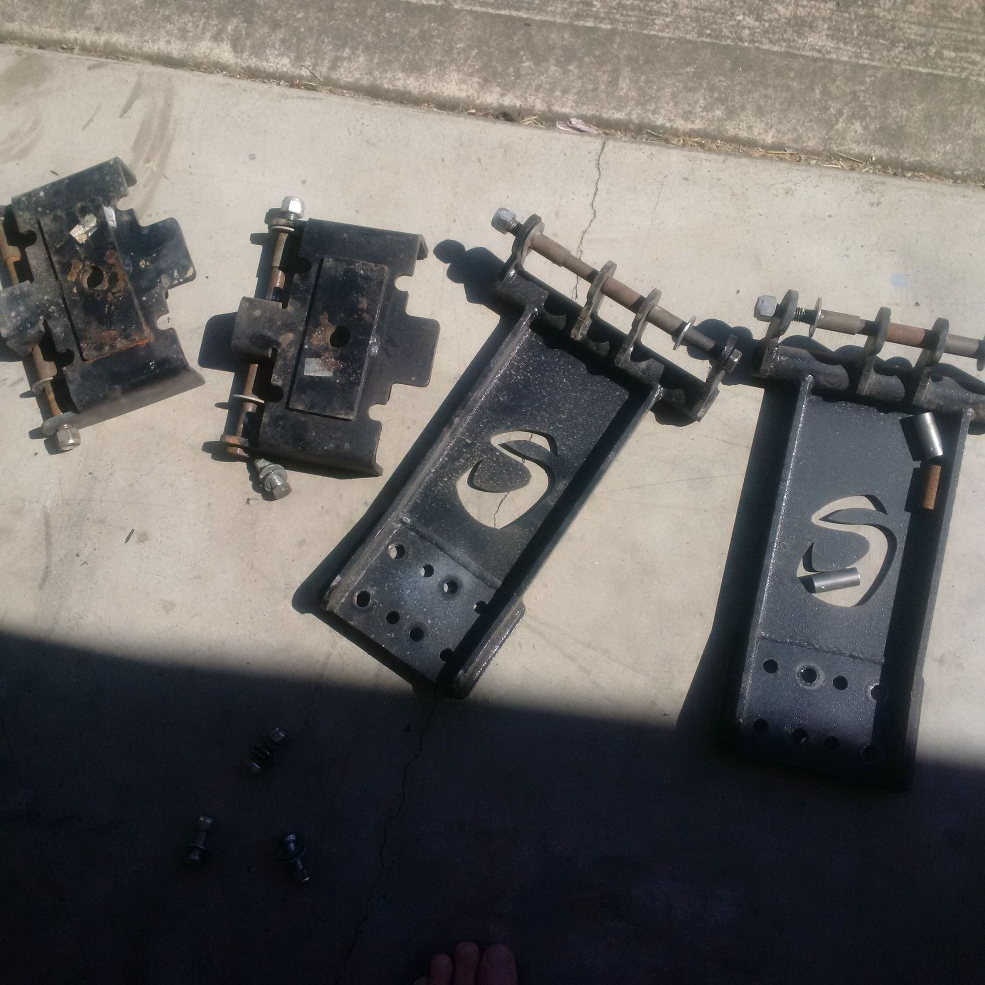

dual shock kit
I have a dual/triple per side shock kit from Super LIft. It says it is for f150/f250/bronco. It was new/unused when I installed it on my f350 and it stiffened up the front end too much for my taste. I probably had is on for less than 5k miles. $100. It is heavy so shipping will not be cheap.
