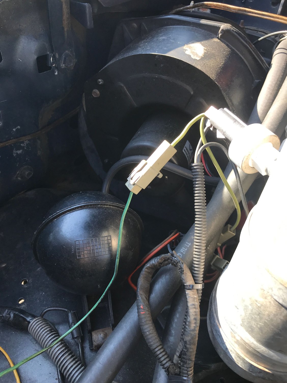

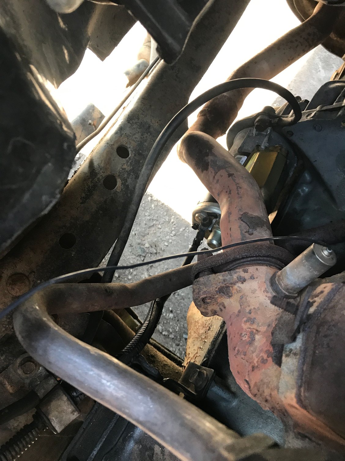

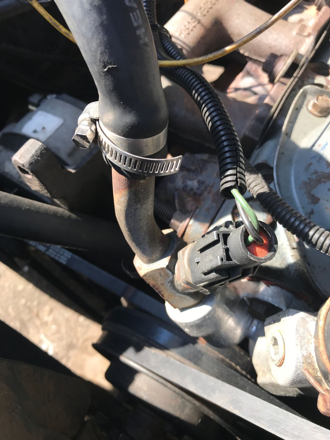

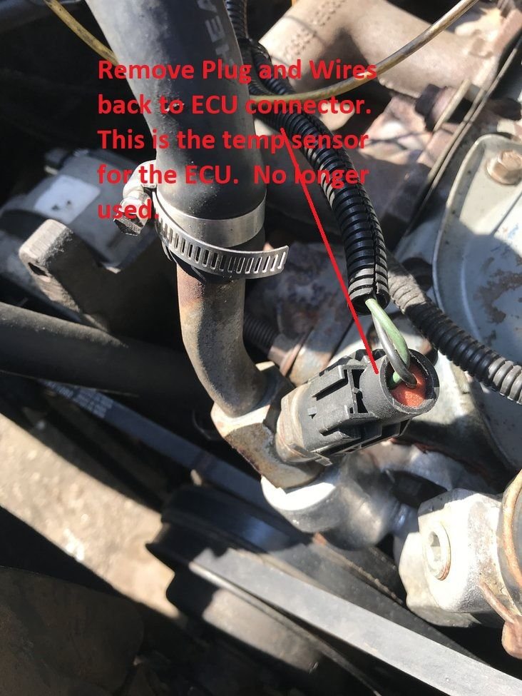

Here’s what’s left, along with the ignition wire, a red wire that goes behind the engine somewhere I can see, the yellow wire to the starter solenoid, and some wires that attach into the harness for the lights on the driver side. There may be a few more that I can’t remember. Basically I just took out the solenoids, the dead connectors that haven’t ever been plugged in since I’ve had it, the old distributor connector, and evap canister.
Ok see below.
Do NOT remove ALL the connectors as not all go to the ECU and ONE of them we may need to use. Specifically, it was the plug that went to the carb vent solenoid.
This should have NOT been tied into the ECU and "SHOULD" be on it's own circuit. But variations exist where it ties into the ECU power for the tab tad solenoids that were removed.
We will look for that connector later....
