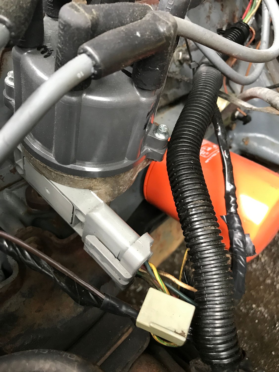

Yes, that is one of the distributors you could use.
What's happening, your TFI distributor is empty except for a pickup and wheel inside. This sends a signal to the TFI module mounted to the outside of the dist. At the same time it sends this same signal to the computer. The computer looks at all the sensors and engine conditions, and then sends back a signal to the TFI module to advance or retard the timing. The TFI then fires the coil at the right time.
Now that a bunch of stuff has been disconnected,, the computer can't make good decisions anymore on the timing. The TFI has a failsafe to keep the engine running, the TFI will fire the coil by itself at base timing, which is wherever you have it set at. The sticker on the radiator usually calls for 10 degrees BTDC. So your engine runs, but only at 10 BTDC all the time.
These older distributors and the retro-fit distributor you looked at have mechanical weights and a vacuum advance unit to advance the timing according to engine rpm and engine load. That's why you need to change to one of these to complete the conversion and get the max power and fuel mileage from your engine.
That is very helpful and makes sense. The truck is running what feels like great to me now, so I am looking forward to seeing what the swap will do.
I have been watching videos on installing one of these, and it seems fairly straightforward. I ordered a new dist, so I plan to put it on this weekend. One question I have is, where does the vacuum line from the vacuum advance on the dist hook up to? Is there a corresponding port on the carb? Also, is there anything I need to be aware of, or tips for getting the timing set up correctly once the new distributor is in?
I don't even see a computer in this thing, and the place everyone shows it is empty. From what I've read, the one-wire distributor will be hooked up to the starter solenoid?
Thanks again for all of the help. I'm brand new to this and ready to learn as much as I can about these trucks!

Find the square ignition coil you have now. You will see a plug with two smaller wires plugged into the coil. One will be darkgreen with a yellow stripe, the other will be a white with a lightblue stripe. Cut the white/lightblue wire and hook that to your new distributor. You may want to change this later when you do your wire cleanup, but this will get you going for now. You can deal with that later if it comes up.
The distributor vacuum advance will work best hooked to a port on the carb that only has vacuum when the throttle is cracked open. You can leave the vacuum advance disconnected at the beginning, and get it running and the timing set, idle speed set, and all that. Then you can experiment and find the correct port on the carb and hook it up later.
Ok, that seems pretty simple. Here is my coil and distributor. I have a dark green and white (I don’t see any blue on it, but I assume it’s the right one.
Do the wires currently going to the distributor just get unplugged and abandoned?
thanks,
Kevin
thanks,
Kevin
With all the years, heat & oil you are lucky you can see any dolor on the wires LOL
They would be the right wires at the coil even if not the colors Dave listed.
Yes the wires that are plugged into the dist. are left unhooked for now.
Once you have it running again and timing set so you know all is good you can then get in there and start removing wires that are not used.
See that oval plug on the right side with all them wires coming through the fire wall?
On the other side is the computer. Unplug the wires from computer and remove the computer.
Back in the engine bay you may need to open that harness to trace out some of the wires.
DO NOT cut any till you know what they go to. I think someone said oil & maybe the temp gauge wires go through it but not 100% sure on that.
I know wires will go to a temp sensor up on the Tstat housing they can be removed.
If you have any question when removing just post and we can help.
Dave ----

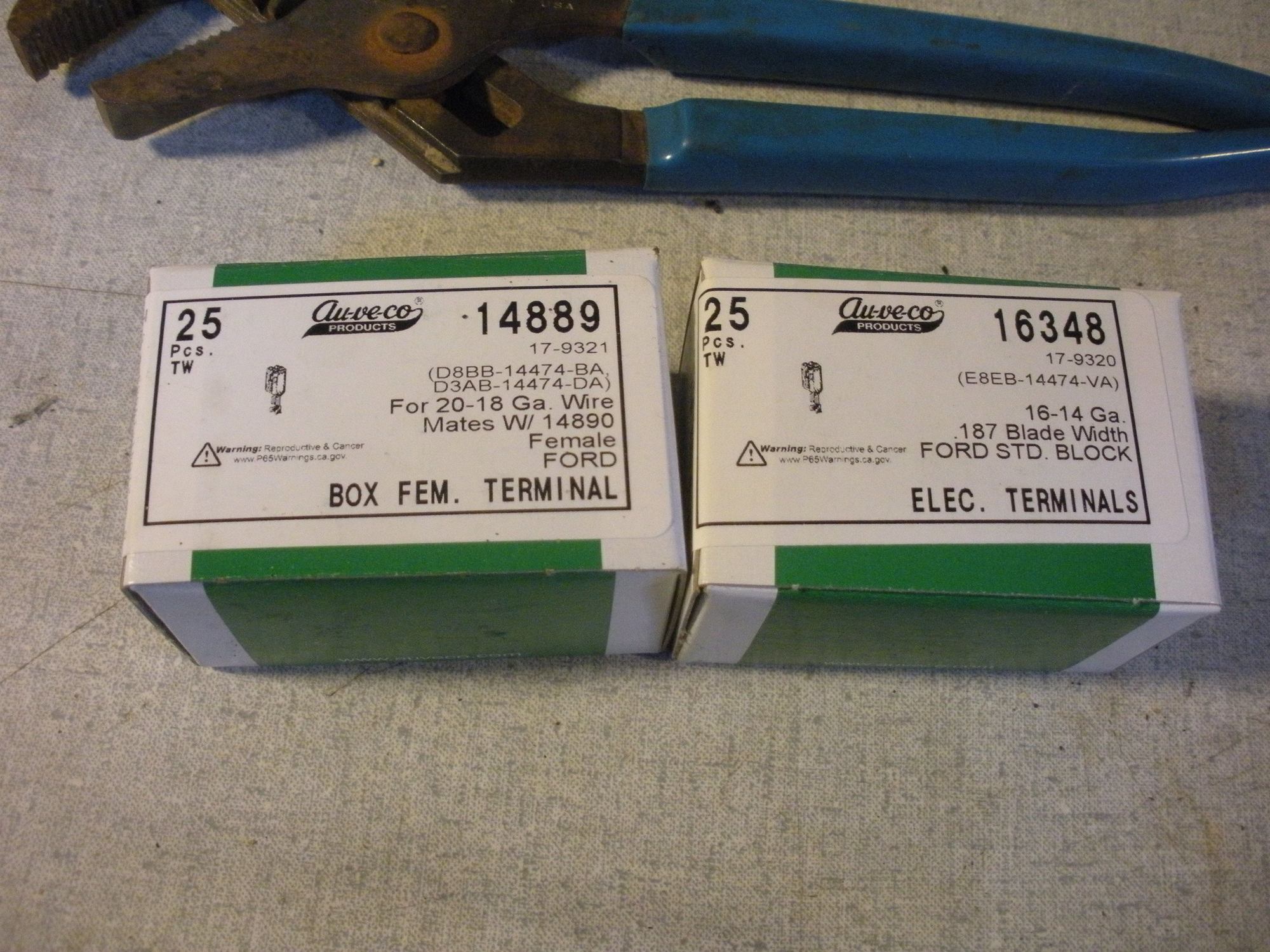

Wouldn't it be better to remove the female terminal from the connector using a small screwdriver rather then just cutting the wire ? I was surprised to see how easy it is to remove the terminals.
I believe it was Matt that gave me this link, I have ordered the correct terminals from, https://www.clipsandfasteners.com/Fo...eners-s/63.htm
OP might like that link for future reference.
Remove the terminal and then what? Re-use that cruddy old corroded terminal? Not sure what the new distributor comes with, if it's a pigtail or what. It probably is not a Ford connector on it though.
Not knowing what condition his terminal is in...it might be wise to leave the wire as long as possible. He can always crimp on a new terminal. The longer the wire he leaves, the more options in the future.
