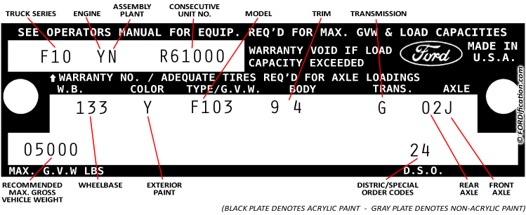

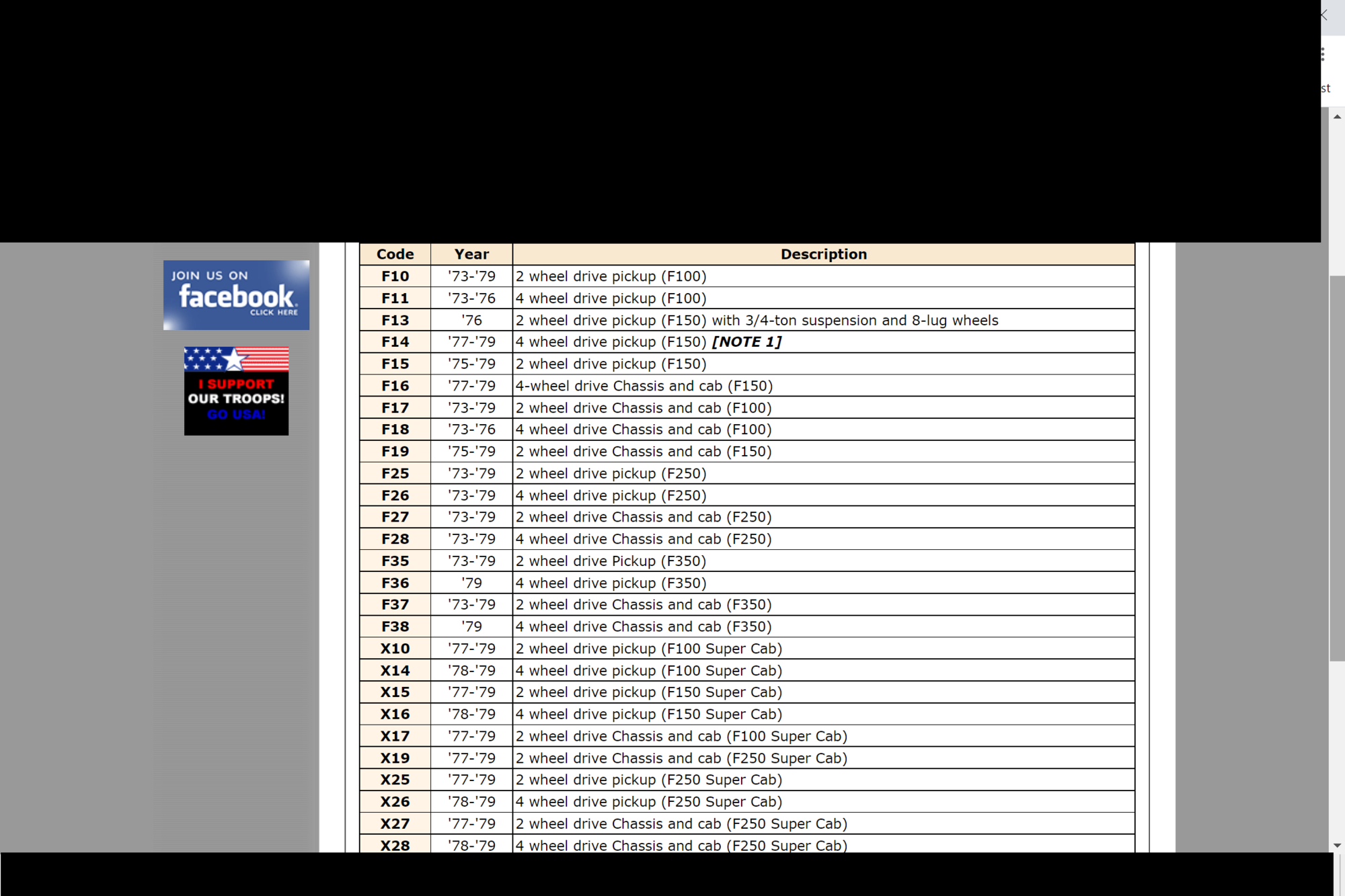

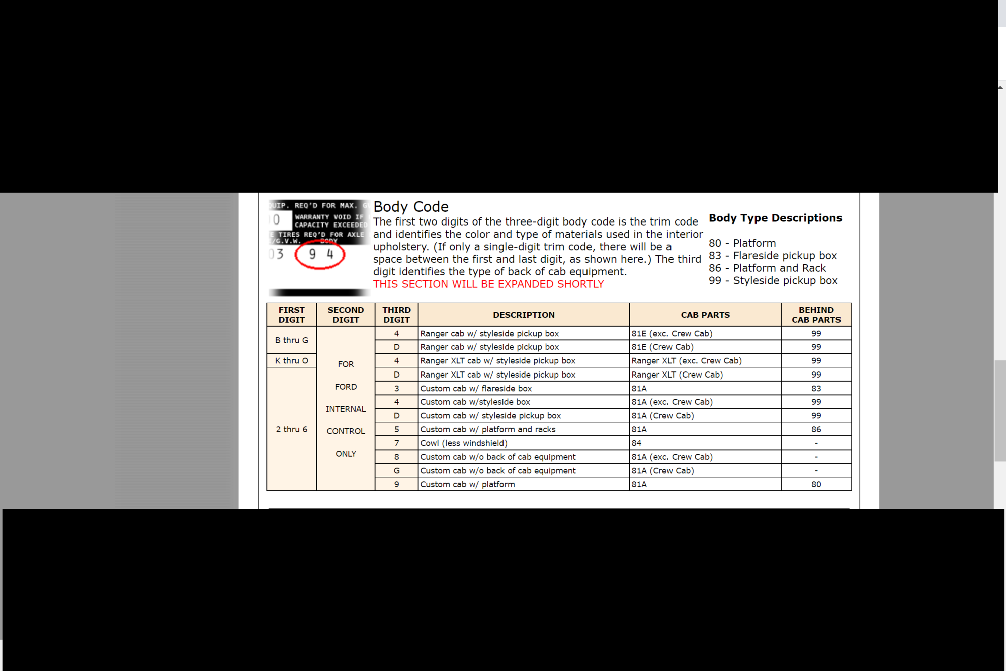

Ask the CC experts. https://www.ford-trucks.com/forums/7...ly-thread.html
According to sources yes you are only going to get a F or an X in the truck series category.
Blue box the rest of the list.
Or ck here for some vin help. https://www.fordification.net/tech/vin.htm
X2 on the "body code" will dictate if it is a RC, SC or CC.
Or check this out. https://www.blueovaltrucks.com/tech-...t-vin-decoder/
