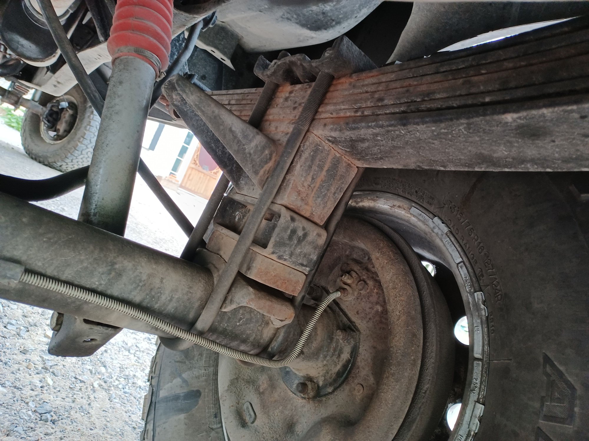

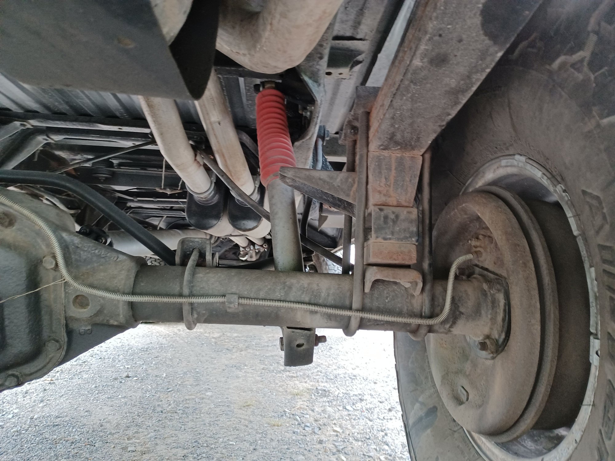

Thank you for your replys. So last 2 pics are my setup

There's like 7" between the spring and bent spring perch with three blocks in between, no wonder it rocks. The miracle is the U-bolts still holding that "Dagwood" together.

I agree that you should at the very least toss the non-factory blocks. That one with the "ear" pointing towards the inside of the truck is factory. The ear is what the bumpstop will hit provided you flex the suspension enough to do that.
Lift springs would be great for giving you that lift back without the use of block. I also agree with getting new spring perches. Those should be nice and flat.
U-bolts will have different torque specs depending on their size (diameter) as well. I used aftermarket 5/8" u-bolts when I had the lift done on my Bronco and I believe that specs for those was something around 145 lb ft. It's also normal to have to retorque them a time or two after the first install once they get a few miles on them.

Also, not sure how bad it is to have it doing that, but it looks like your passenger side e-brake cable is sitting on top of your exhaust pipe.
