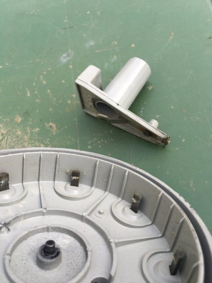

What's the general consensus on how long a distributor cap/rotor should last? I've been using genuine Motorcraft brand caps/rotors on my '84 351W. My truck doesn't get driven much, and this image shows what it looks like after only about 5k miles over 3 years:
I was getting a heavy stumble in the 1200-1500 RPM range, and a new cap/rotor took care of that. But alas, the one I installed was another Motorcraft so I suspect it will not live very long again, either. I know a cap/rotor are considered normal wear parts, and need to be replaced on a regular basis, but 5k miles seems way too short.
Note how the posts seem to be aluminum or some similar alloy. I noticed a NAPA version has brass posts. I'm wondering if that would be a better option. Any thoughts, favorite brands, etc.?

You can usually find brass versions cheap on rockauto.

I'll go 10 years or so, I don't drive mine much either. I've told the story before. Back in the mid 1990's I bought a "life time" cap and rotor, when I paid the kid I told him this store will be gone by the time I have enough miles to replace these. I replaced those about 15 years later in 2013.
3700 miles since Nov 2011. 49,800 miles since Sept 1991.

Looks like you've got a lot of resistance, might check and or replace the coil and plug wires.
