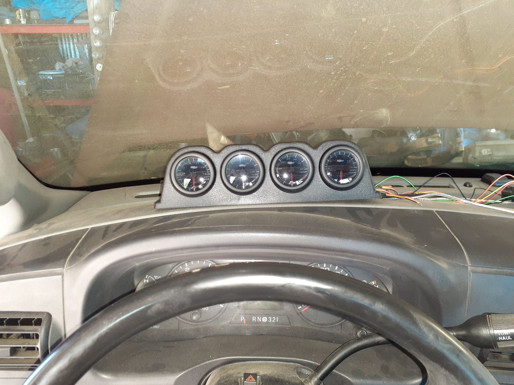

So, I got a four gauge pod put together. Now where to put it. I think directly in front of the driver's position it won't look right. Nor does it fit the contour of the dash. I would have to sand the bottom to get it to fit right. Over the radio it fits a lot better, but still a little contouring work on the bottom of the pod will be needed. But then it will angled away from me a bit. So I would need to **** it toward my a hair. I think it still looks better over the radio. B.

For trimming the pod to fit, I would make a template by sanding a piece of 1/4" mdf or masonite on my bench mounted belt sander, double stick tape it to the pod and use a flush trim router bit to cut it to the template.

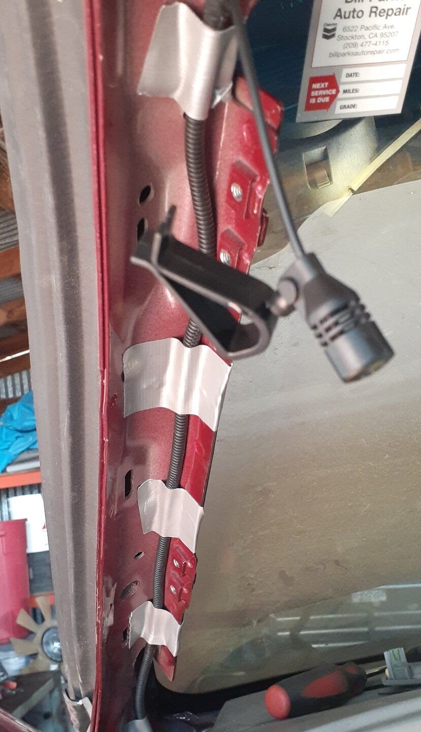

While re-installing my dash, I changed out the stereo head unit mic. The one I had installed got caught between some metal and cut the cable. Since that was 2 1/2 years ago when I did the stereo, I was a little ticked off when it did not work. I finally got around to fixing the issue (LOL). This time I wrapped the mic wire in 1/8" wire loom to protect it.

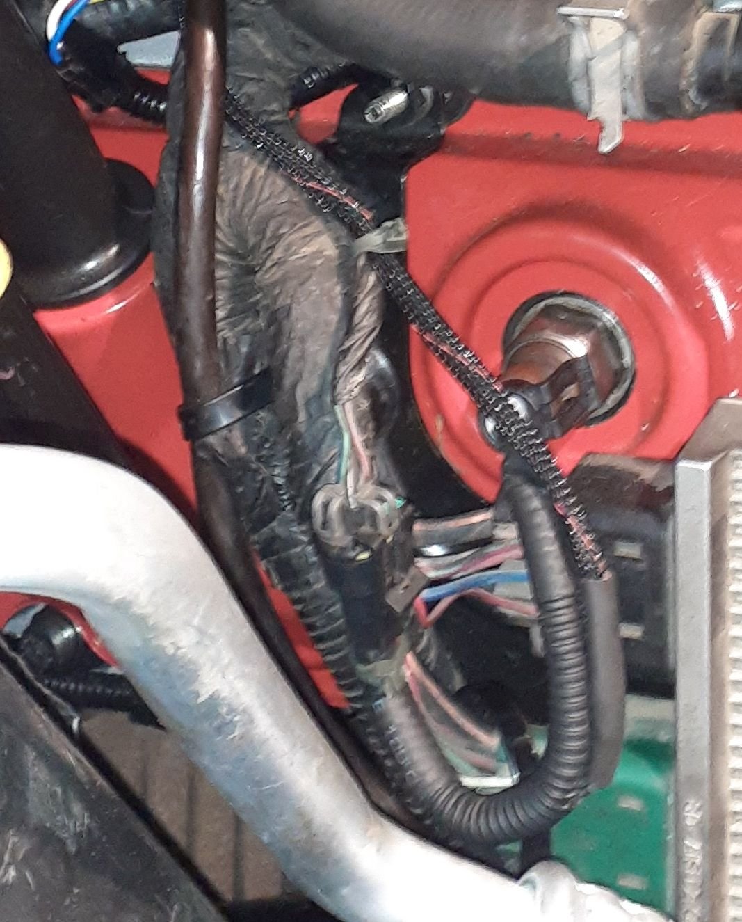

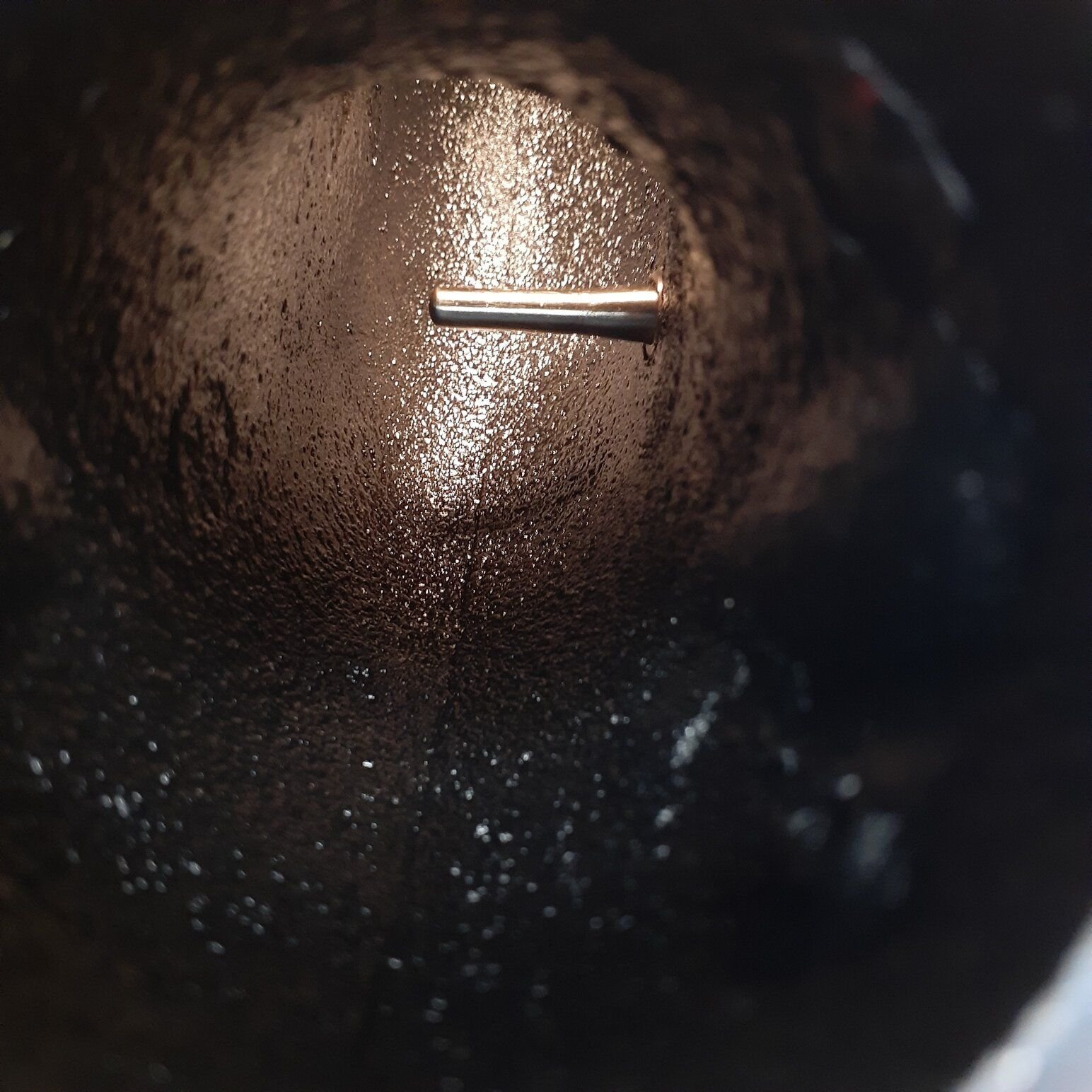

Ok, I ordered the GLow Shift Max Tow coolant pressure gauge and a single "A" pillar pod to put it in. It's not here yet. But, I got the fuel pressure gauge sending unit and the HPOP pigtail installed. Very neat. Plenty of room for the fuel pressure sending unit. Fuel pressure is steady at 60 PSI with minor drops to 57PSI under WOT. B.

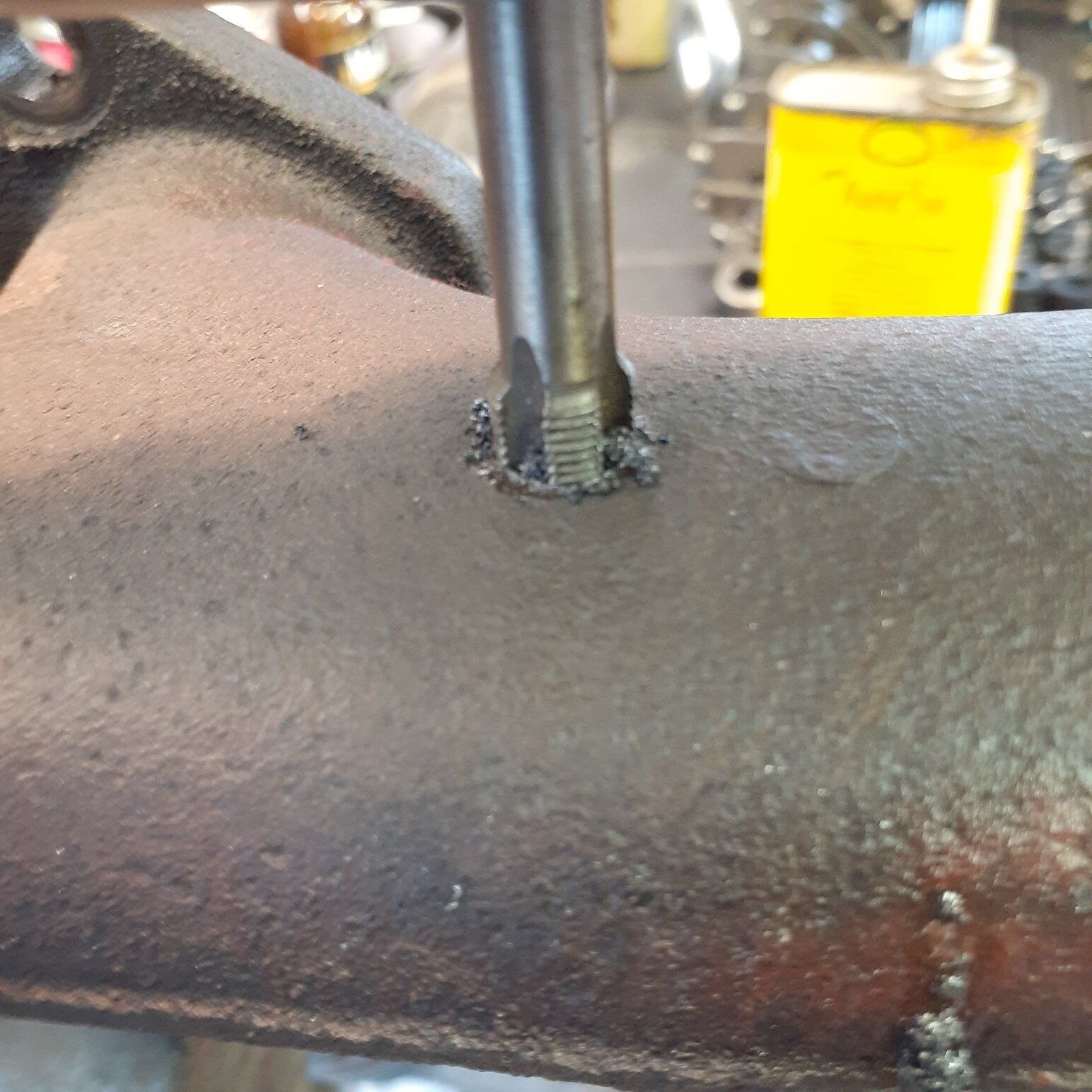

The EGT probes. One for each bank. B.
