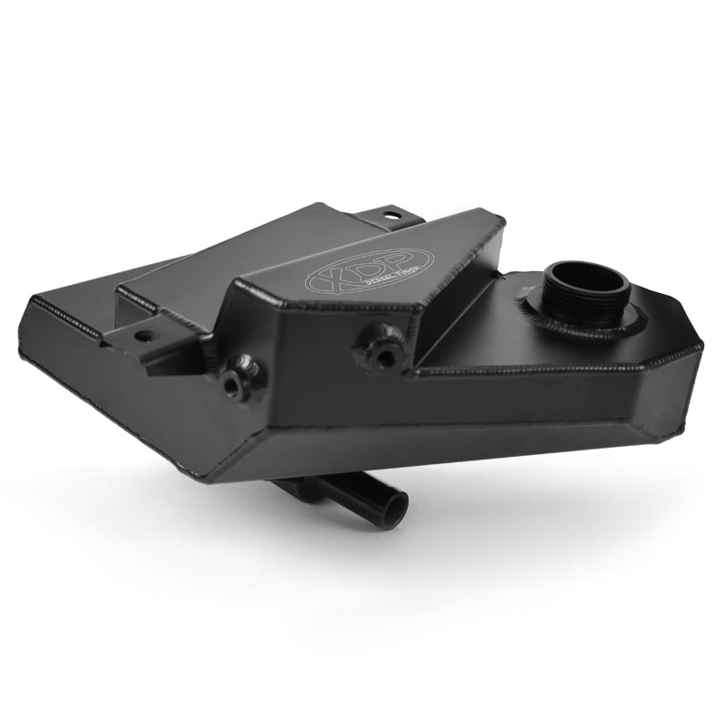

Originally Posted by LindenBruce
Uummm....... There are several already on the market right now. Mishimoto is one. But there are several other brands out there as well. B.
Yes, there are several aluminum degas tanks on the market, but not one that I've seen with a threaded lug in the location where 87crewdually and I mounted the sensor. Mishimoto has a threaded lug on the front of the tank, in the perfect position where the sensor could be sheared off if not removed before pulling the air filter/intake assembly. Not to mention the welds look like azzz....
I guess on the XPD version you could screw the sensor into the passenger side port if you're going with the coolant re-route mod. And it isn't shiny so that should make Jack happy.

The Sinister and DK Engines pieces look very similar. B.

The XDP, Sinister, and DK Engines pieces are most likely made by the same supplier and private-labeled.
