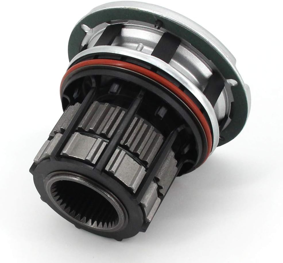

The Warn hubs are stronger, more easily serviceable, easier to buy replacement parts if needed, and have no plastic in them like the OEMs.
Ford even offers them through Ford Performance now:
https://fordauthority.com/2020/05/fo...d-performance/
https://performanceparts.ford.com/part/M-1104-SD
Warn:
OEM:

My lovely Ford PVH hubs suffered from not only a failure to lock, but a failure to unlock. This means that you may be driving 3 hours on the freeway with a single hub locked. You cannot forcibly unlock a Ford auto hub - the positions are 'auto' and 'lock'.
I tossed them and installed MileMarker manual hubs (lifetime warranty) when they were on sale years ago for $99 (now $150 at Summit Racing). These only fit Fords through '04.
