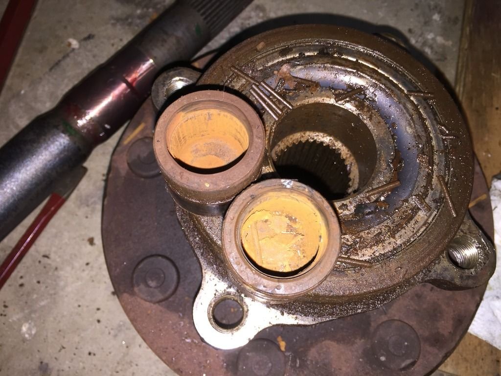

if your already stuck and try to use auto4x4 most likely the hubs will explode like what happened on this '17 f250. . putting to much faith in this vacuum hub system can really leave a person disapointed. as many have said, its going to fail, just matter of when
Yup...that's why the Warn hubs are in my Amazon shopping cart just waiting for a good deal. A little over $300 can "fix" the OEM vacuum hub issue too. Anything mechanical with moving parts can fail...lets not kid ourselves.
Just a small amount of finesse prevents that from happening.
When one shifts to 4HI then immediately stands on the throttle............BOOM.......for sure.
With the torque that these modern engines are making; Clubfoot Clodhopper will be lucky if he doesn’t take out the whole front end.
