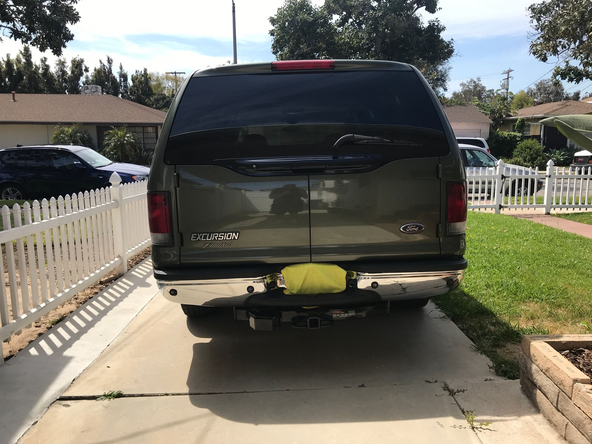

If you have a 2wd and stock size tires and no lift, I’d be afraid anything lower than the Curt could have a tendency to scrape the ground going out of driveways. I’m even scraped mine once. They hang pretty low!
