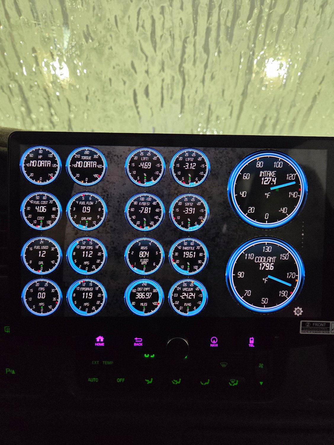

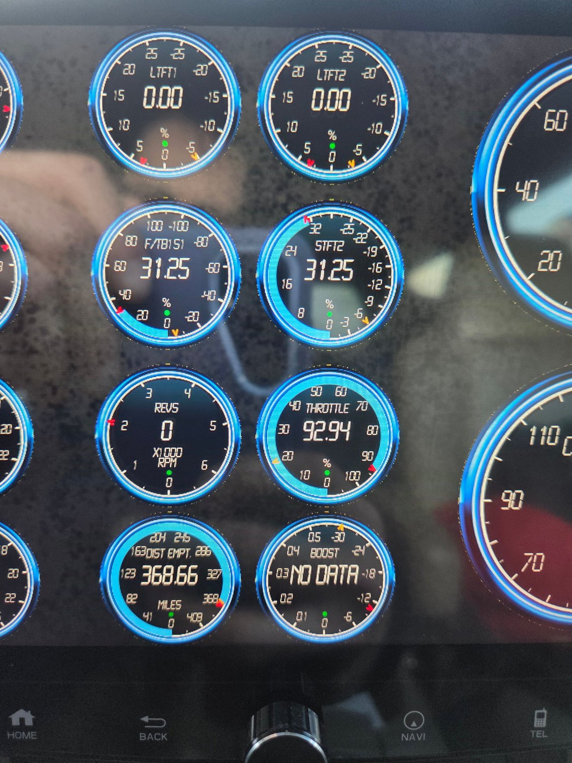

I replaced the IAC a few days ago and the TPS a few days before that. The IAC was definitely nasty, but still moved freely. Once replaced I performed the idle relearn. As far as the idle goes, it is improved as is the decel to a point. I still don't think it's going into fuel cut off at high speeds all of the time. I notice my STFT go to 0 when slowing down most of the time but it is not 100%. Both fuel trims are still leaning out the mixture more than I would like to see.
I am not seeing any vacuum leaks. The idle is butter smooth, HVAC operates as it should, and per Torque, the vacuum is between 24 and 27 in/hg at idle.
My next plan is to parts cannon maintenance items at it. It has 336k on it, so new O2 sensors and a fuel filter aren't a terrible idea.

If Torque can graph multiple PIDs you will have a better picture of what is happening. Forscan on a Windows laptop can graph PIDs and the software is free and you can use you existing dongle.
