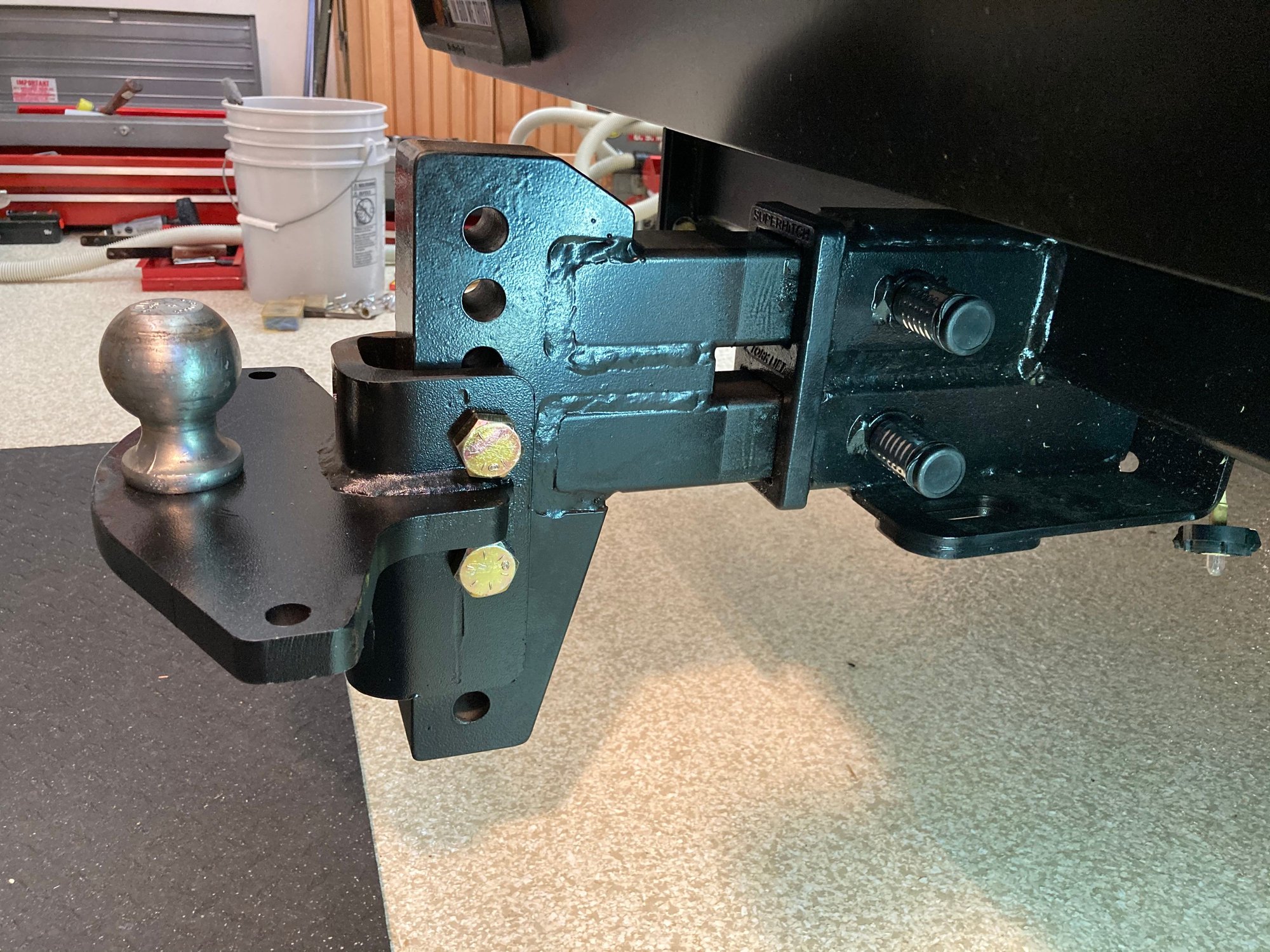

If you get a Torklift hitch, you should get one of these. It doesn’t tow any better, but looks cool.
