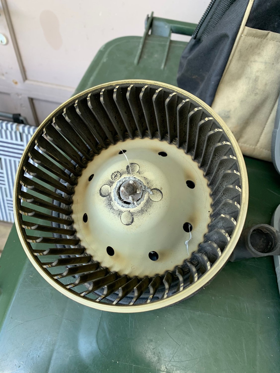

I did mine back in August, 2020. The wheel had separated from the motor shaft. Not a bad job. I’ll include pics showing the failure and the new Motorcraft wheel and motor. Can’t recall the prices though.
Failure of wheel.
