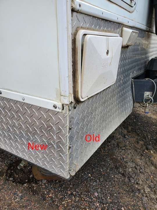

The corner molding on the front will be replaced when I put on the new fiberglass. When I fixed the delamination of the sidewalls I put on new molding that had a longer leg along the sidewall. The original molding didn't quite cover the sidewall fiberglass. The factory used caulk to cover the gap. Unfortunately, the new molding wasn't long enough to go all the way down.
The section where the two diamond plate aluminum sections come together had a separate piece of molding that was thin, cheap and all broken up, so I didn't put it back on. The new section of diamond plate aluminum I ordered with a clean 90° bend and no curve at the bottom. You can see the curve in the old section of diamond plate aluminum on the front of the trailer. I may have to replace the front section of diamond plate. It's starting to tear where it comes into contact with the tongue. If I replace the front section, I may eliminate the shower box since I never use the shower.
The question I have is, how far down should the corner molding go? The new molding I have waiting to go on came in 16' lengths. I have plenty of length this time to cover the corner, all the way down to the bottom of the diamond plate. But I'm thinking that I'm going to cut the molding off to mate up to the horizontal molding. What do you think?
The other side where I did put trim all the way down. If it was one piece it might look OK, but with the seam it looks like crap.

I would just run it to match the horizontal run rather than go all the way down.
Steve
