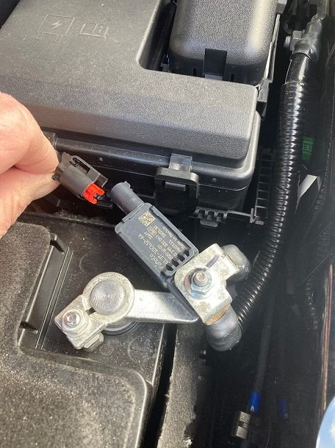

On my 021 Ranger, just unplug this from the battery connection.... no more start/stop foolishness.
