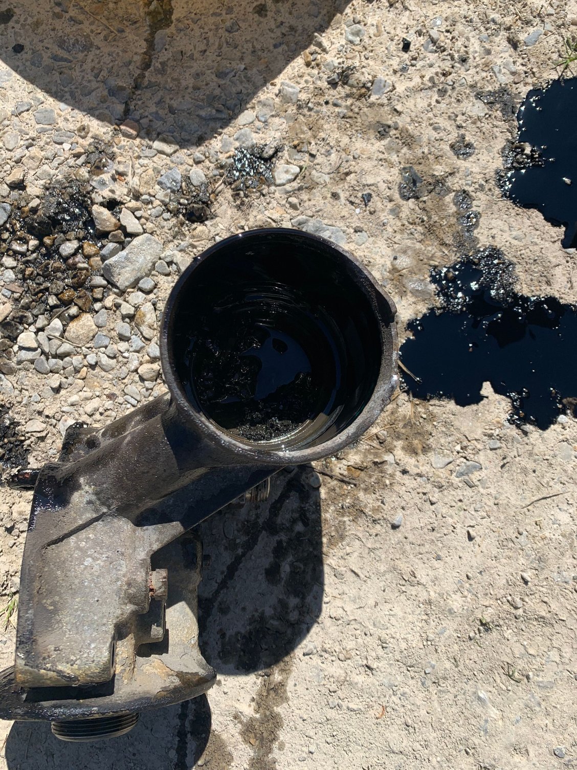

Wow what a mess I found today. What is plastic in the cooling system? Water pump impeller? Lots of little pieces of plastic in this mess.
Old Apr 20, 2021 | 09:45 AM
Sous's Avatar
Sous
FTE Leadership Emeritus
Joined: May 2014
Posts: 27,352
Likes: 5,946
From: Lake Hartwell, GA
FTE Emeritus
That is quite a mess...
Are you sure it is plastic and not a sealant like RTV that found it's way there?
What did the gaskets and mating surfaces of the oil cooler look like?
@SkySkiJason was working on a customers truck that had a similar blockage of RTV. Not exactly the same though.

I was wrong it was not plastic chunks. Must be scaling or rust from the motor. It crushes right into dust when poked with a screwdriver. I guess it was just way overdue for some maintenance. I am going to flush it thoroughly and put fresh G-05 coolant back in there. Im doing both radiator hoses and a new tank while I have it apart
I always try to flush the cooling system before removing oil cooler. Remove block drains and let water hose run with engine running and water pouring out drains until it runs clear. Then reinstall drains and drive around the block. Then repeat drain/flush. Do this until system is CLEAN.
I would not use G05. We prefer an OAT extended life coolant like Peak Final Charge, CAT EL1, Rotella ELC, etc.
Good luck!!
