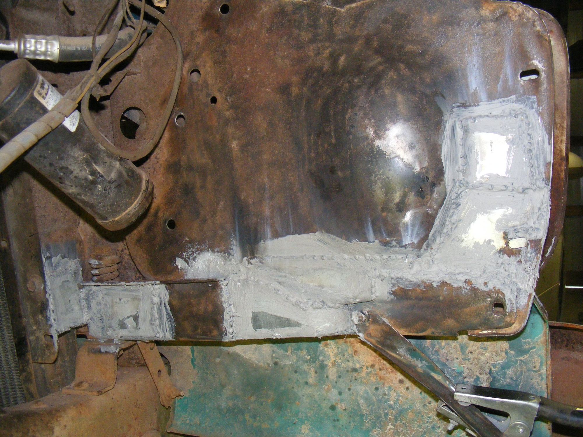

I made the patch for the inner fender (same place as the other side, right up by the firewall), welded it in and applied seam sealer. Then I degreased the inner fender and sprayed it with Rustoleum primer. Once that's cured I'll put undercoating underneath and satin black Rustoleum on the engine side, just like the left.

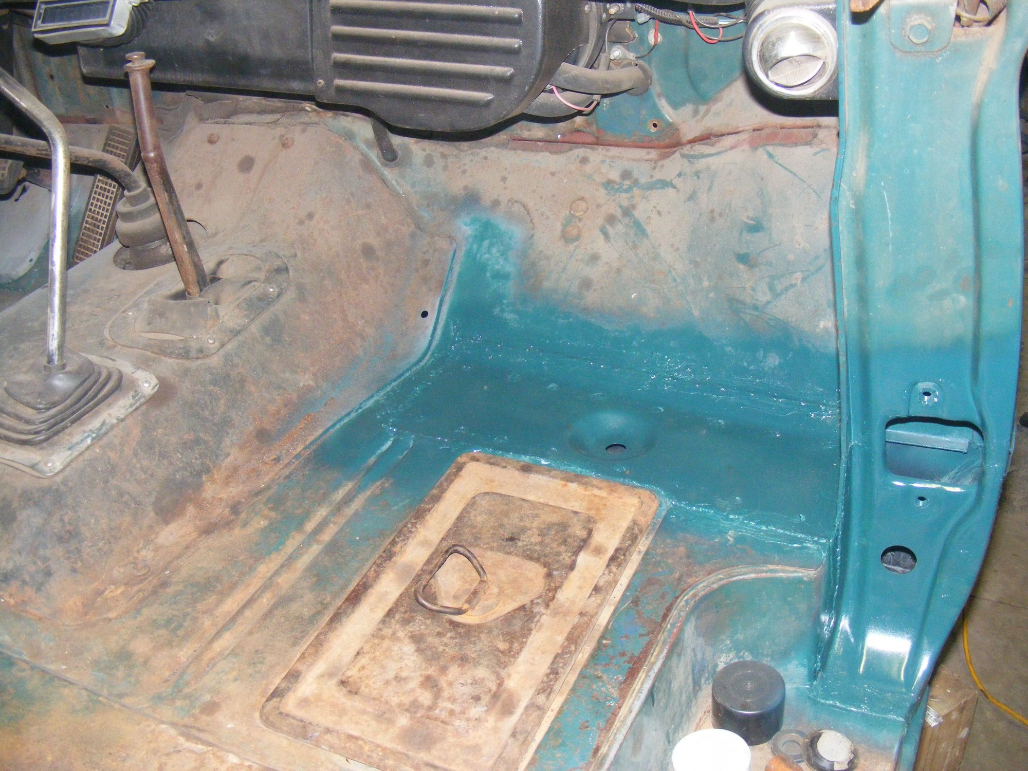

This is the floor pan section sitting in place, after drilling for plug welds and applying Weld-Thru to the underside. No point in priming/painting the topside yet, it'll just burn around the plug welds
I also drilled (8) 5/16" holes for plug welds in the cab mount vertical flanges. Next session, I'll weld it in, then weld the floor pan to it.

Floor pan welded to original floor and to cab mount flanges. After the seam sealer cures, I'll prime and spray it Ford Holly Green.
I put four plug welds in the forward flange of the cab mount. The other four are going to have to be done underneath with my clumsy left hand, just like the left side was. Meanwhile it's sitting on the bushing until I drill the through-hole in the mount and install the bolt.

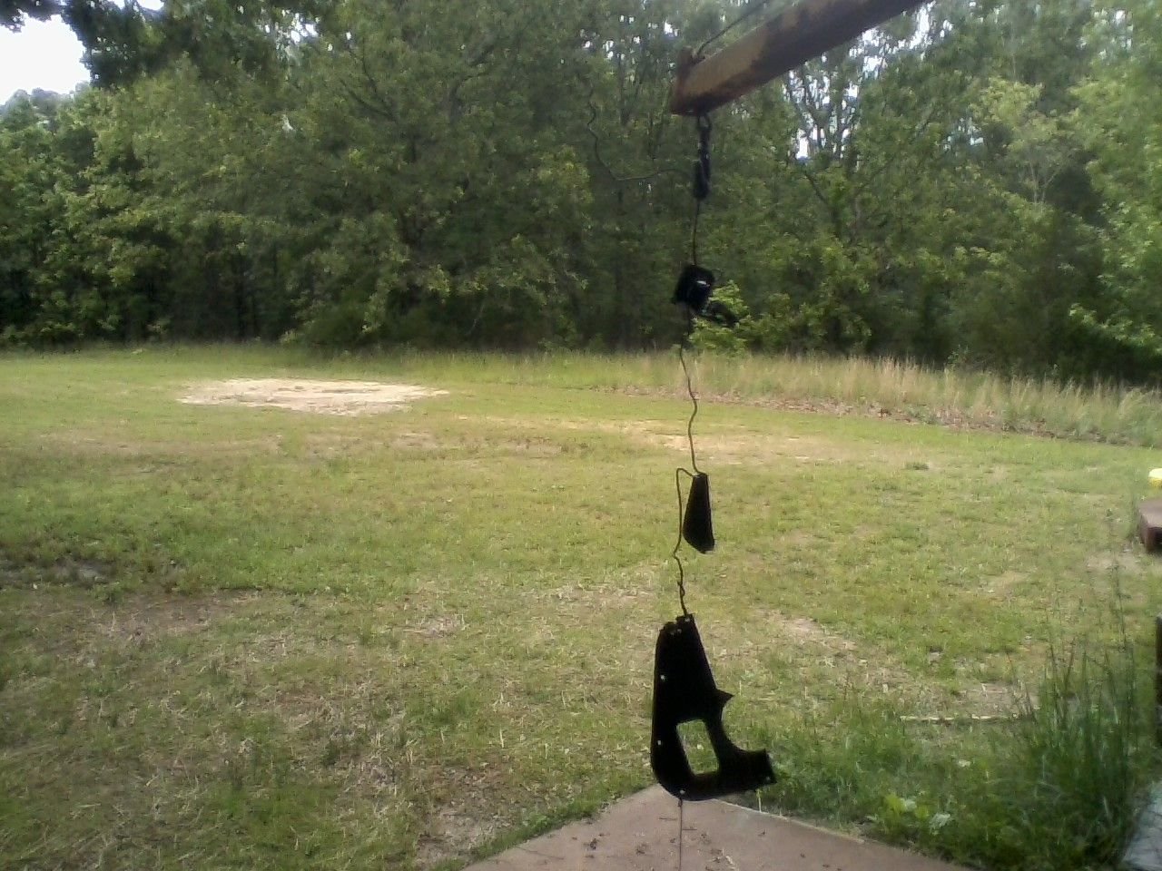

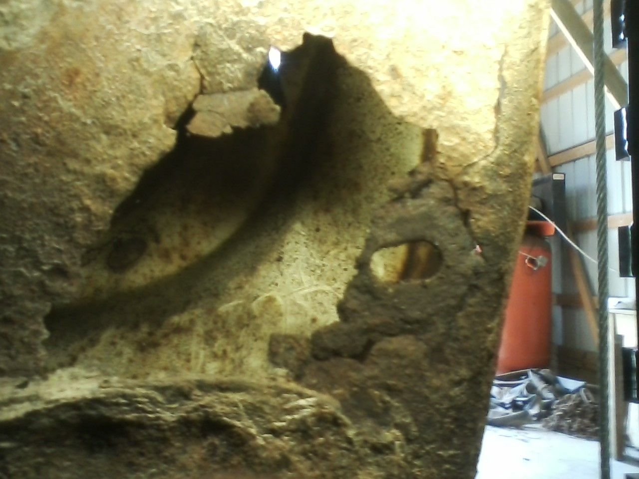

This was fun to cut out and patch!
Radiator support nearly detached on this side, too.

Patched and sealed, ready to prime and paint
The finished repair. I may undercoat the part that's exposed in the wheel well.
The repair after seam sealer/prime/paint. Now I have to do the rest of the floor... or get carpet At least I'll bead-blast and paint the battery compartment door.
