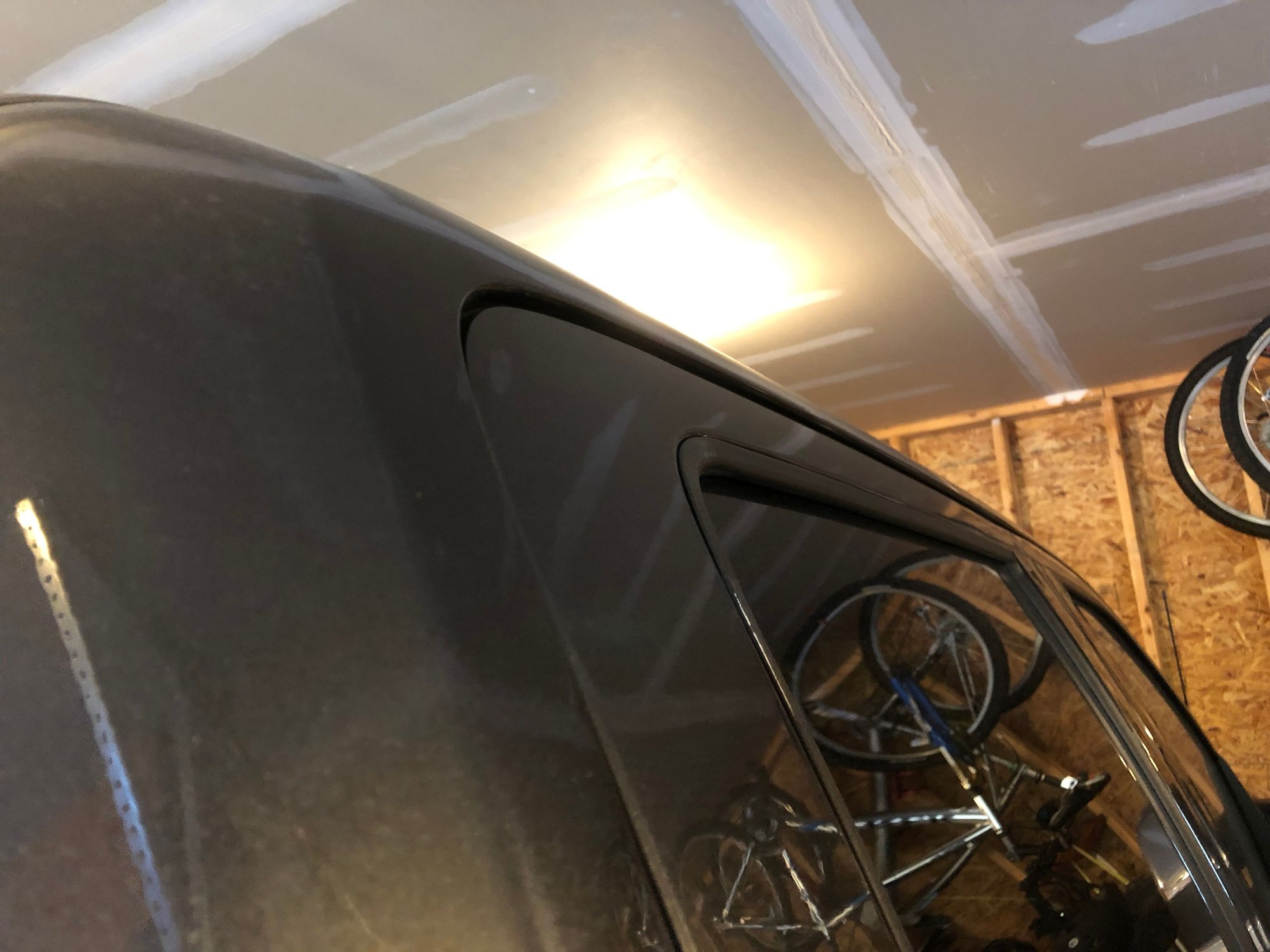

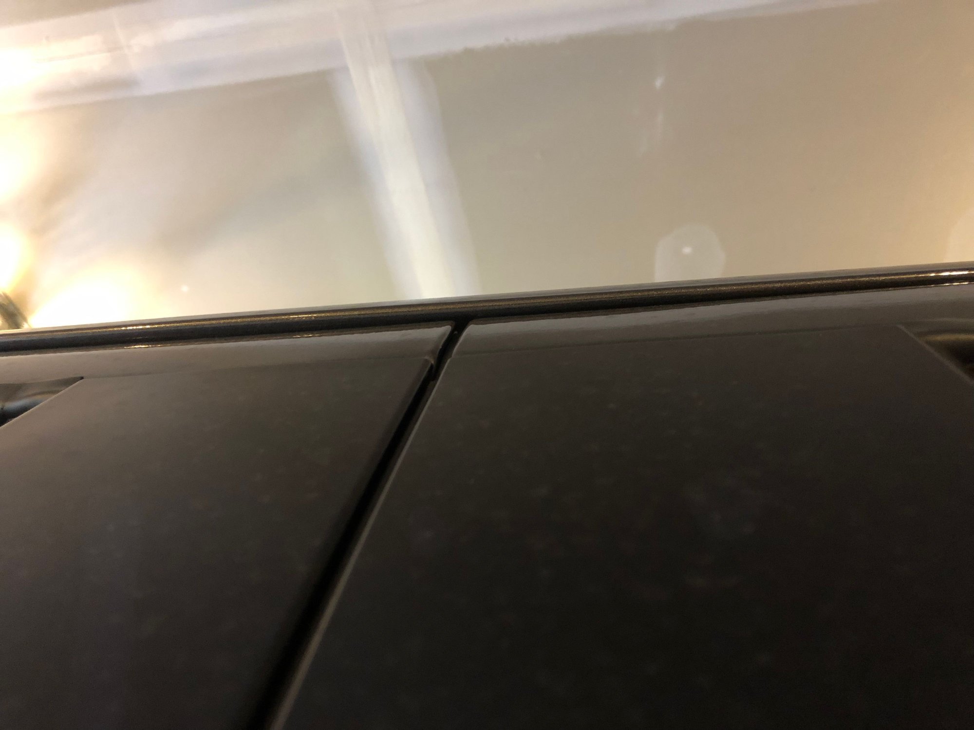

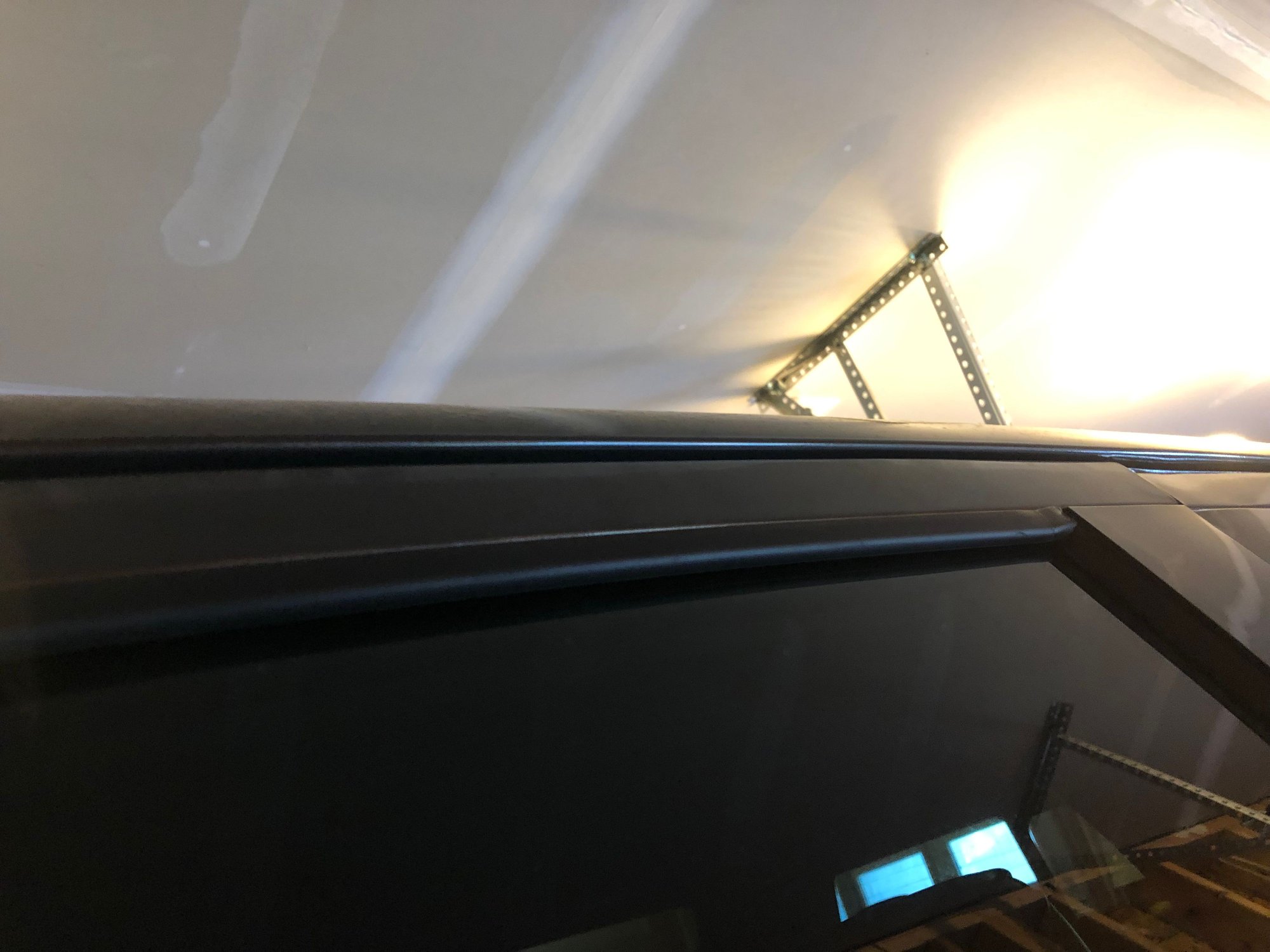

I have had a rattle in my drivers door since I got the truck a year ago. Two different dealerships couldn’t figure out the cause. A third had their body shop make some adjustments to the door and now the rattle is 100% gone. However, now there I have had a rattle in my drivers door since I got the truck a year ago. Two different dealerships couldn’t figure out the cause. A third had their body shop make some adjustments to the door and now the rattle is 100% gone. However, now the top of the door is not flush with the edge of the cab like it was before. But, I looked at the other doors and they all sit in an 1/8 to 1/4 of an inch at the top of the door. The rest of the door is aligned and flush with the pillars and other panels. Anyone else have doors that sit in a bit at the top?

I have a regular cab, and the tops of my doors are sucked in compaired to the rest of the door. Alot of these trucks have poorly adjusted panels. If the rattle is gone and you dont have a whistle while driving.....i would just live with it.

Looks like they fixed your rattle by adjusting your door in putting more pressure on the seals. I'm with the dentguy above...I'd live with it. I've seen a lot of these aluminum trucks with very poor fitting panels. Aluminum body parts + mass produced product on an assembly line = poor fit & finish.

The photos make me believe said body shop did their "adjustments" by bowing your doors. The latch strikers in the door jambs are not adjustable as they were on older vehicles. Go ahead ... pull one off and you'll see there is only one position in which it can be located ... was what I did when I started chasing a rattle. A door can be bowed manually using various methods, the most common of which is to position a (blanket covered) block of wood in the door jamb and force the top and/or bottom of the door towards its closed position ... and intentionally deform the door. And as you found, it ain't pretty, but it works.

The rattle was coming from the door bouncing around on the striker. They didn’t bow the door. Just angled it inward at the top. They didn’t touch the passenger side and it’s got the same spacing. I know they didn’t touch the passenger side because the truck was dirty and there are clean (cleaner) spots on the drivers side where they were handling the top and bottom of the doors but the passenger side was dirty all over. The door bolts are also scratched up on the drivers side and not on the passenger. I looked at all of this when I noticed the gaps because my initial thought was the drivers side was way out of whack. Then when I saw the passenger side was the same I thought maybe they adjusted both sides. But there’s no signs that they touched anything on the passenger side.

If they didn't attempt to deform the door, the only other thought that comes to mind (and this is without looking at how the hinges are arranged) is perhaps they inserted a shim behind the upper hinge to induce some outward tilt. I've done that before. If so, that could also lead to a buffeting sound at higher speed since the door seal is not compressed as much as it once was (buffeting from air causing the seal to open/close or flap repeatedly at certain speeds).
When you say the "door bolts" are scratched up, are you talking about the hinge bolts? If so, take a closer look to see if anything "new" (and unpainted) can be found between that hinge and the cab. And if the right-rear door appears untouched, do you think it was out of alignment beforehand?
I'm probably wrong, but I thought I read somewhere that because the strikers are no longer adjustable, different size strikers are available for situations like this ... may have been in an F150 forum.
BTW, I cannot see your entire 3rd photo ... can only see part of your garage ceiling.
