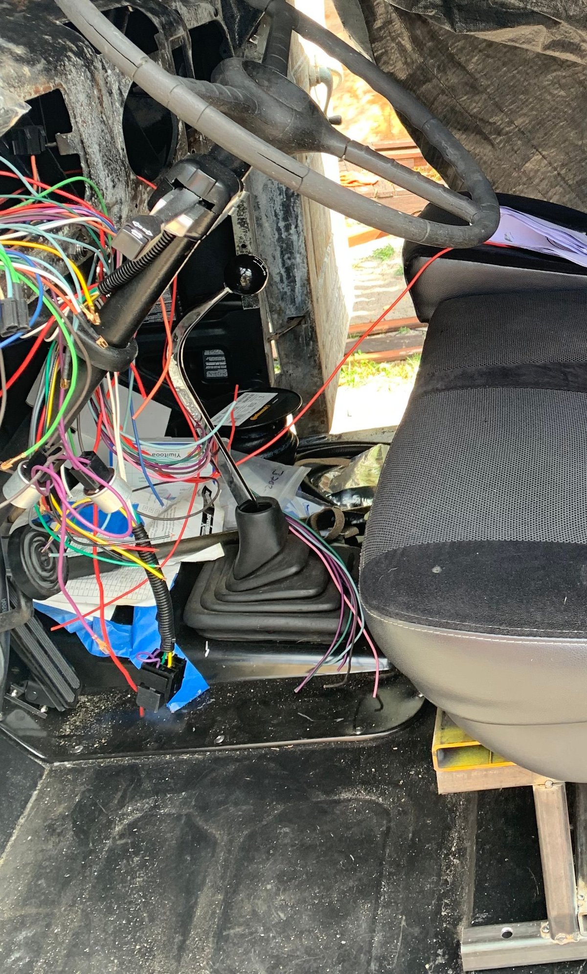

As 49George said, the shifter moves back some, but plenty of space for the bench seat with the right shifter/stick set up.
I replaced the S10 shifter with a Hurst shifter and stick (a bit too short for me, but useable), but you can also modify the S10 shifter to accept other sticks.
This is the position my shifter ended up. Seat is a replacement (rear bench from a Mitsubishi Outlander) , but in the same position height as the original seat:

Old Mar 31, 2021 | 01:21 PM
drdre's Avatar
drdre
Joined: Apr 2019
Posts: 70
Here's a better picture on where the shifter position ended up for me. Based on my initial setup with the flathead, it should be more or less in the same spot behind that engine.
