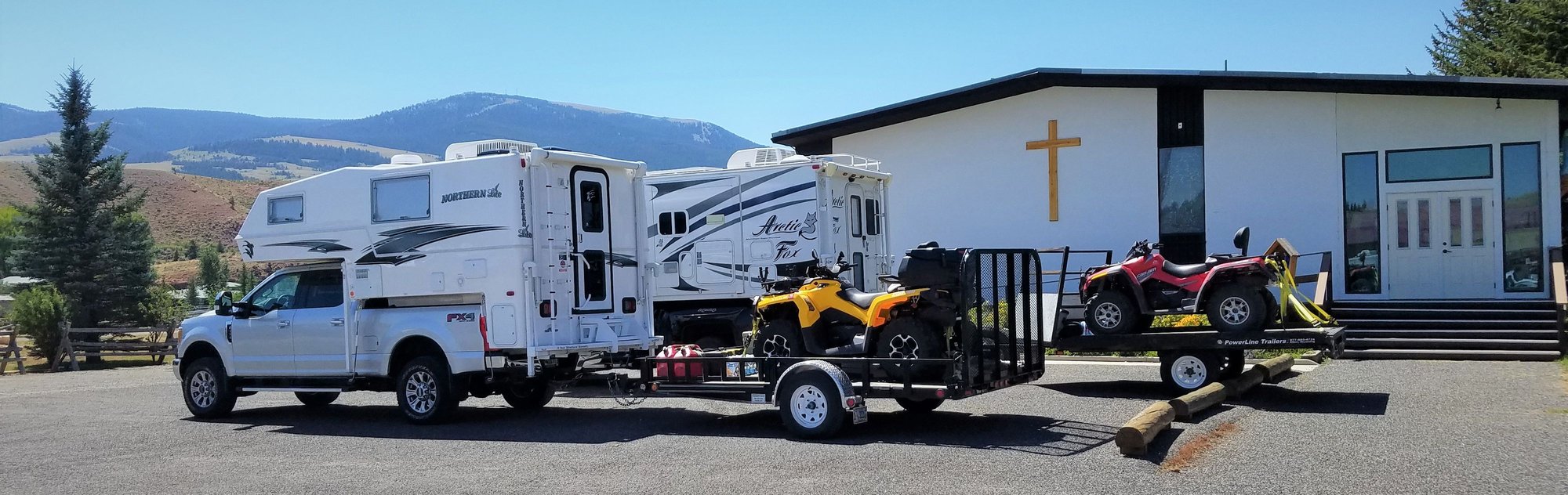

Below is the Reese hitch extension I have used for several years. I tow a PJ Trailer model 8312, which means it is 83 inches wide and 12 feet long. I carry a CanAm Outlander Max XT ATV (two person) along with coolers, bikes, kayaks etc..
My hitch is set at 34 inches , which at that length it extends to the edge of my bumper on my camper. I am very happy with this extension for what I use it for. I have never weighed my trailer tongue but when loaded I would be very surprised if it is over 350 lbs. I have included a photo below of my Northern Lite with my trailer hooked up to it.

Dang nice setup. The NL makes us jealous as it will definitely be our next rig. This photo is what we needed to see. Expect our towing to be similar.
Thank you and glad to try and help out. This photo was taken in Dubois, just before heading about 22 miles into the mountains with my best friend and his wife. We go up there every year at least once if not more. Beautiful part of our state for sure.

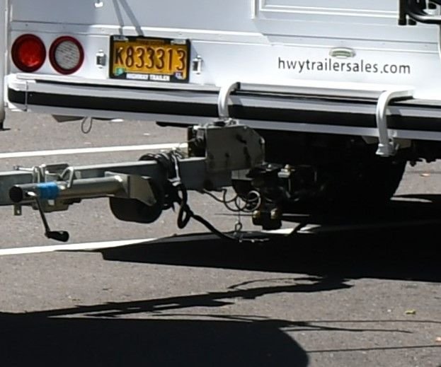

Here is another closer up photo of the hitch extension for you.

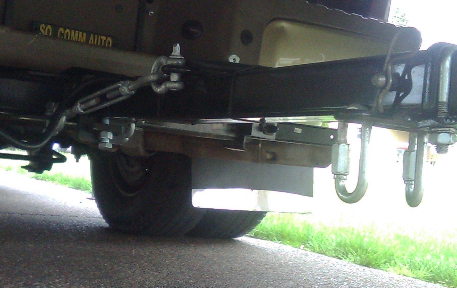

Hydraulic brake reservoir makes it a requirement to get the ball completely clear of the rear bumper.
This was the initial set up for this bar. I had new loops welded on about half way up so that I could use bigger turnbuckles with chains and angled further out to the left and right.
Thanks for the closeup. Our setups are nearly identical and this is very good to see others towing as well. Dubois area sure is an amazing place including the very large 'jackalope' in that country store. We ride sleds out there near Brooks Lake lodge in the winter. I think the Wind River range and the Brecchia Cliff area right there at Dubois are prettier than the Tetons. Might see us out there sometime. Cheers!
