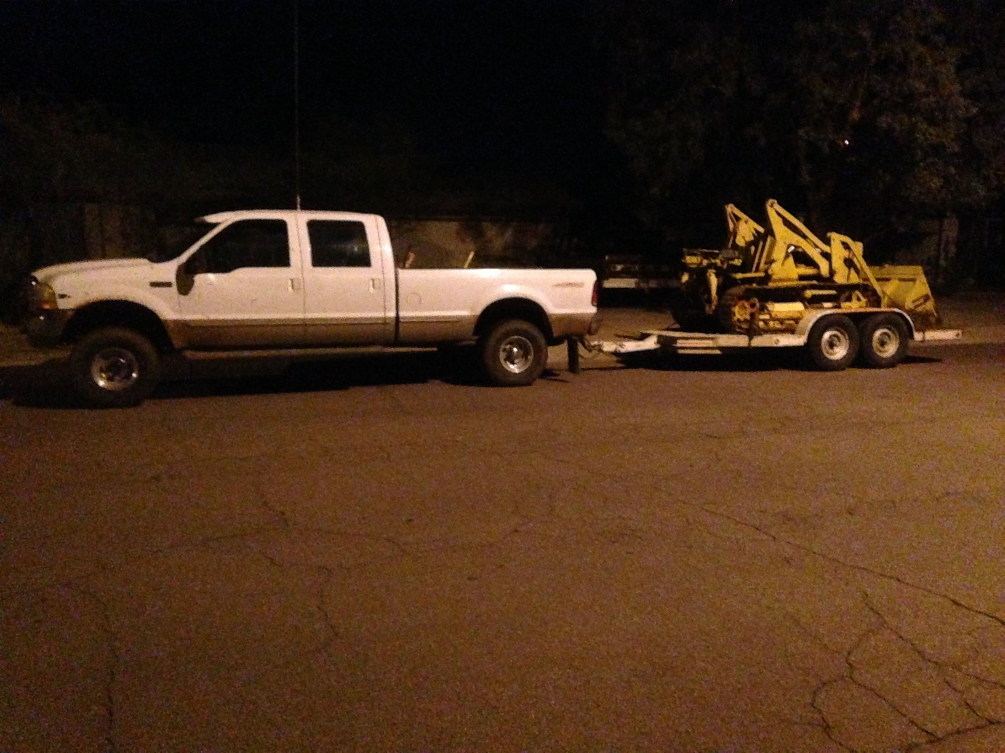

Just to add to the fuss about ratings, here is a 12,000lb machine on a 3,000lb trailer, hooked to a 5,000lb ball rating, with a 4,000lb/ 400lb drop hitch, with around 1,000lbs tongue weight in the factory receiver. Pulled and handled like a dream...

Okay, now that is over the top!

equipement trailers are generally pintle hooks.
Uhaul car trailers are just a ball hitch...and you are over 5K.
