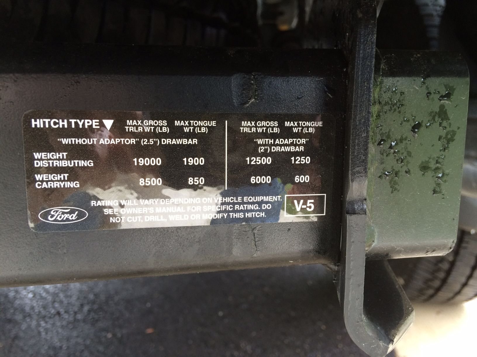

Here is the label on my hitch. 2016 F350, Crew Cab, PSD, Lariat, 4X4

Originally Posted by wh-7
Mine came with it as well, but as I understood reading the manual, using it would lower your tongue weights as opposed to not using it.
When you use the sleeve you are probably limited by the drawbar capacity in most cases.
