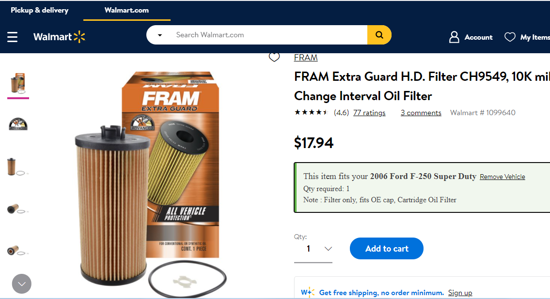

Walmart does sell the Fram CH9549 which contains the "adapter disc".
Old Mar 21, 2021 | 03:52 PM
TooManyToys.'s Avatar
TooManyToys.
Joined: Dec 2014
Posts: 17,830
Likes: 3,115
From: Jersey Shore
Yep, I remember seeing that there, too. If I remember a little cheaper then the Ford, not sure that’s still true or not.
