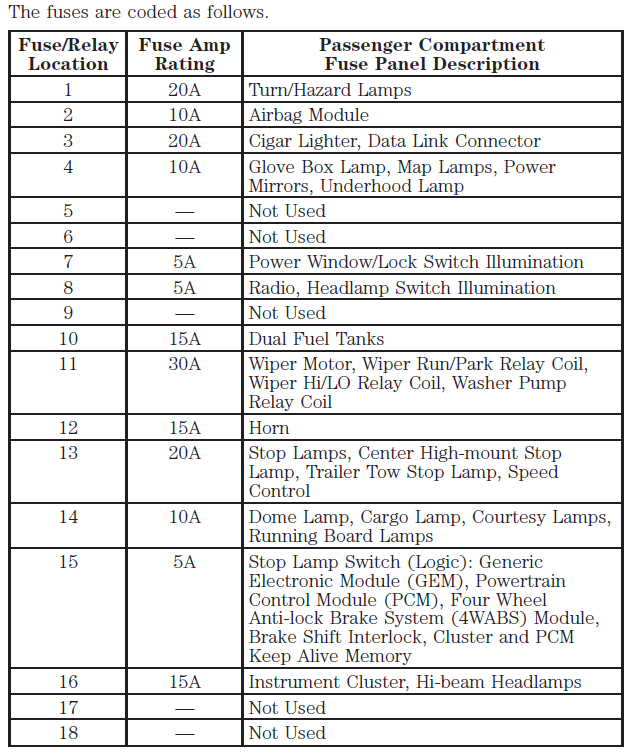

Also, according to the 2000 MY owners manual, the PCM is in line with fuse #15 or #30 under the dash. Should be the same for a 2001 MY.
