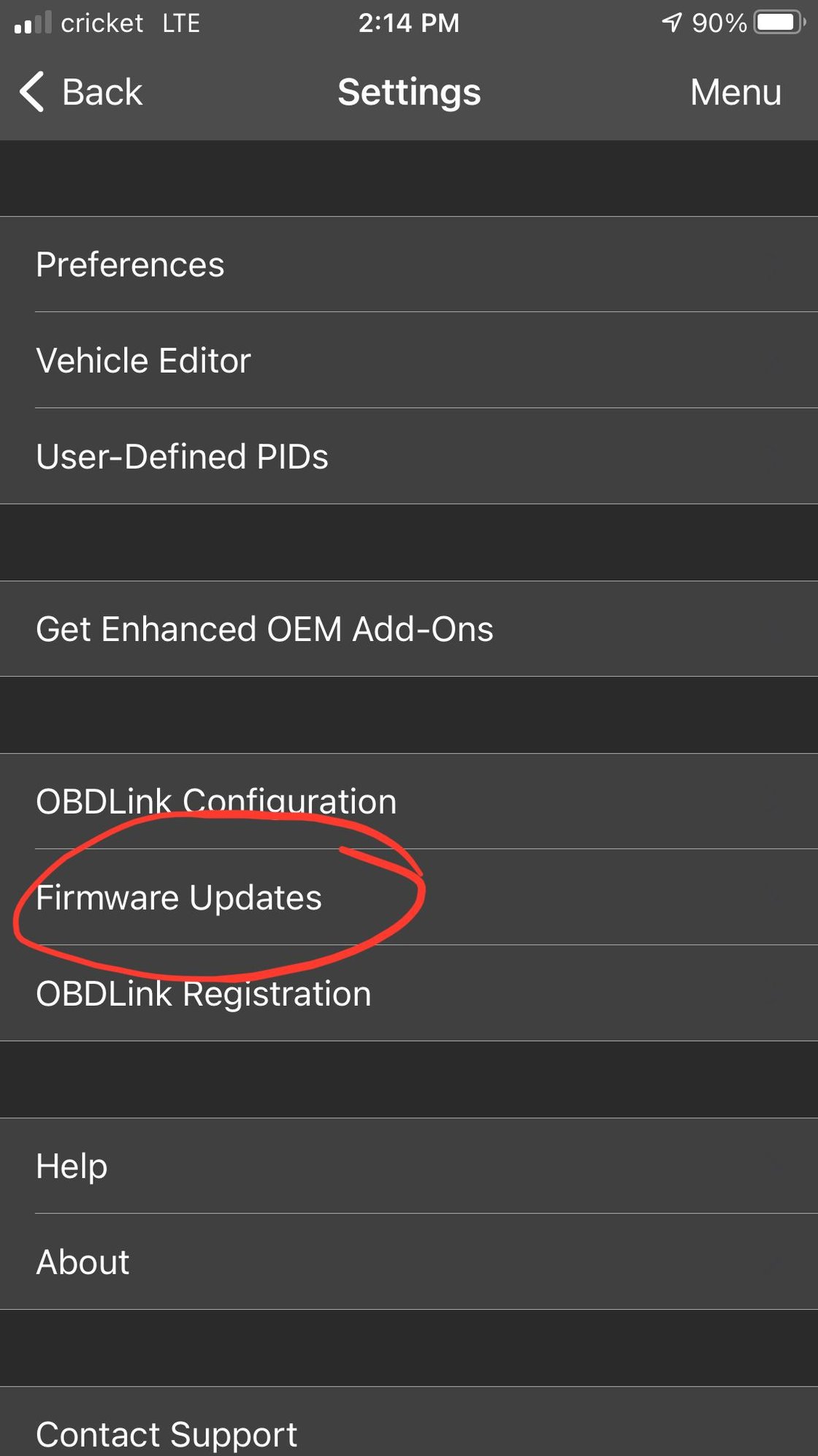

OBDLinkMX+ Firmware Update
How do I do it? I found the updates online but no explanation on how to get the file into the actual adapter, and I am no computer whiz. I figure the adapter will have to be plugged into the vehicle so it will have power but I have no clue how to get the downloaded update into the adapter. I know the "+" model has WIFI capabilities but I have only used it with Bluetooth.

https://www.scantool.net/downloads/updates/obdlink_mx/
To install an update via the OBDLink app, navigate to 'Settings' > 'Firmware Updates', then click 'Check For Updates'
To install an update via a Windows PC, download and extract the archive, then run StnFirmwareUpdater*****.

I did mine through the included OBDLink app. Connect the device to your phone, open the app, go to settings, select “firmware updates”.

Been trying and I keep getting "update failed-timeout getting info from device"
