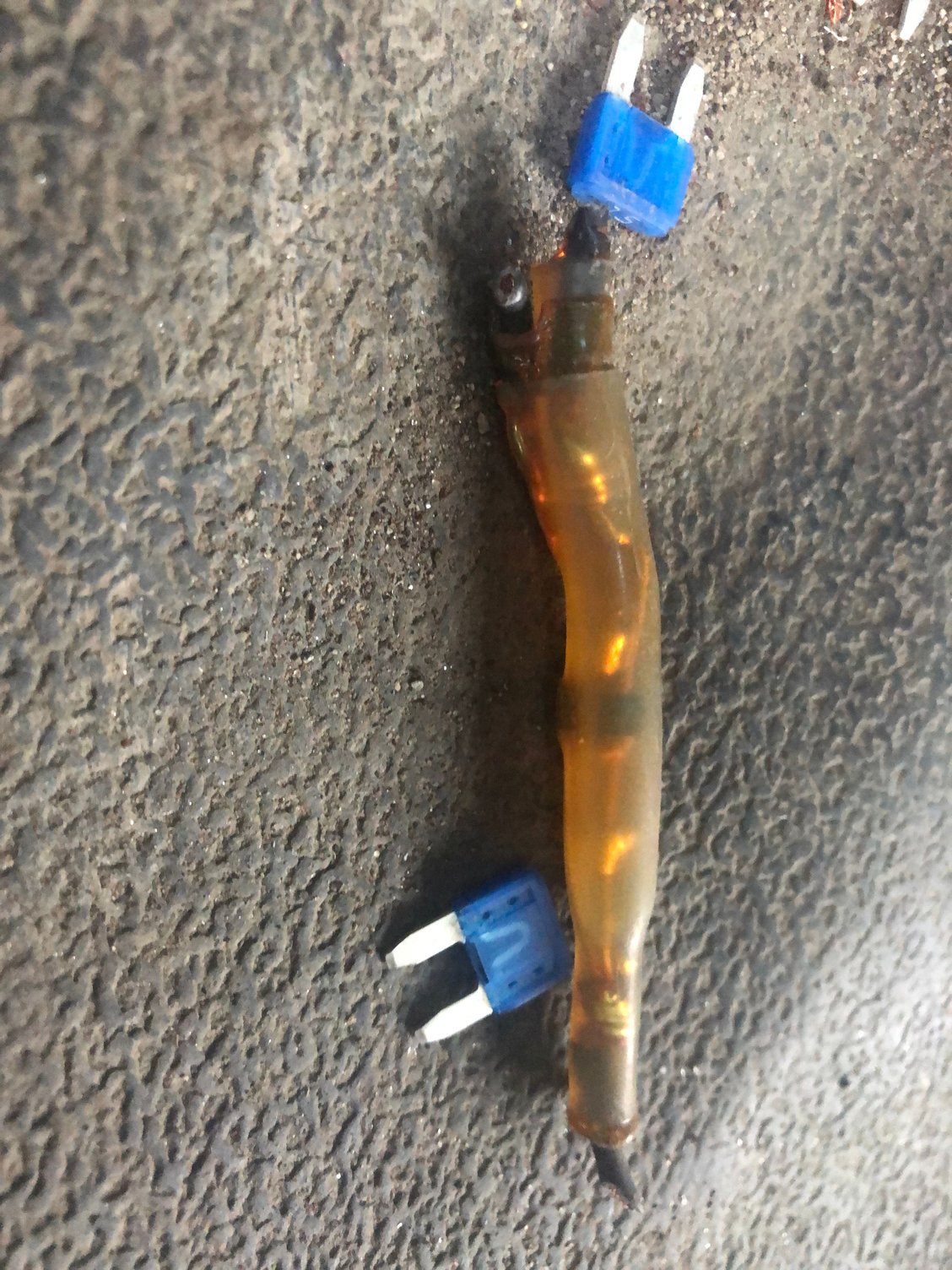

I have a 03 shuttle bus that was starting fine then I removed more of the aftermarket wiring and checked my starting after each wire's cut or removal. next day I go to start it and its cold here so its a cold start but had it plugged in for a hour ... it did not turn over the first two try and on the 3rd I gave it a little gas and the entire system shut down. so I tries again and it again cut out like a kill switch when I touched the brake or the gas... now I get no crank at all but I get all the clicks or at least all the ones I think I should hear. I checked all the fuses and some of the relays I thought would matter if blown and nothing so then I try the screw driver to the pos and neg of starer and I get the loud click and a small electric current from the screw driver connection .... The brakes are making a click when ever I push them key in or key out, I removed the interior panels prior to this happening so I am not sure if that click was always there or not... I have found wires that may have gotten spliced during the tear down. these words I cannot find what they are for ? I looked in all the electric and other links but nothing I could positively make sense of ....any help is appreciated!
this is two I cannot find the other end or where it originates from
this is the was attached to the photo with the two fuses in heat shrink wrap but I just reattached them as they were orgrinally

Its not the batteries ..they are charged up and reading on my voltage tester. Do u happen to know what those wires are for the black and blue and green?
