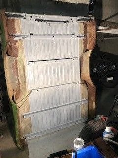

Was able to get some work done in my parkade, flipped the bed off and started taking off the surface rust on the underside.

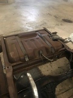

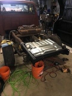

While i had the bed off i decided to swap out the old fuel tank

Finished with the underside and any of the frame I could get to. Also cleaned up the bumper and put some bedliner in. I am not worried about the inside of the bed at this point.

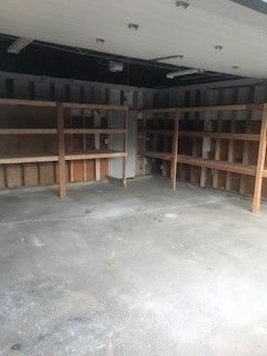

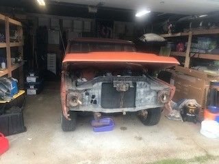

I was able to lease garage/storage space for a year so I have put myself on a timeline. I also bought a small welder.

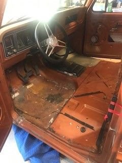

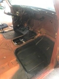

First job was to get the scrap metal the PO had laid down over the rust in the floor pans and then cut out the rot.

I had bought the generic floor pans, but noticed from the underside that this area would be a rust issue in another 5 years so I cut out and made a panel. Not to shabby for someone with zero welding and fab experience.

Finished off both sides, I havent done too much to grind down the welds as I am thinking its good to keep all the strength and its under carpet. It was a learning experience and I am getting better with the welder, but I have to to go back and look at it before i paint the interior.

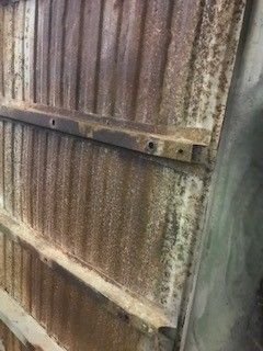

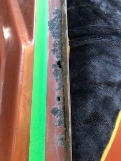

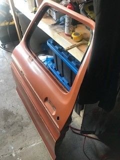

The bottom of the doors are not as bad as I have seen but still needed attention. This is the passenger door.

I ordered patch panels for the lower outers but needed to fabricate the inner. Still need to drill the water channels and fold over the out lip

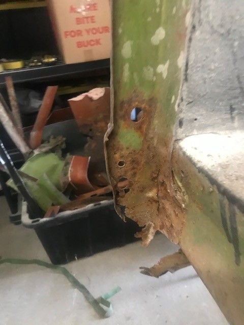

Grille is out, looks like the PO had some impact on the passenger side. The bracing was bent as well.

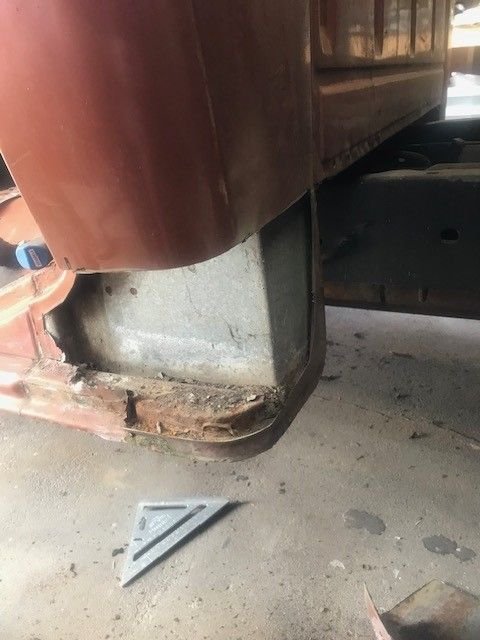

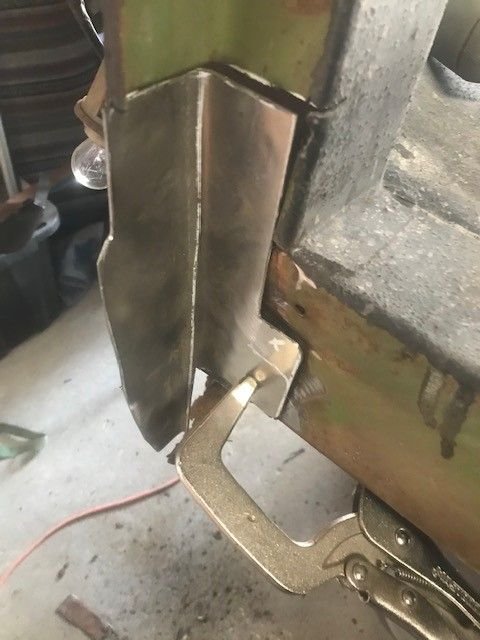

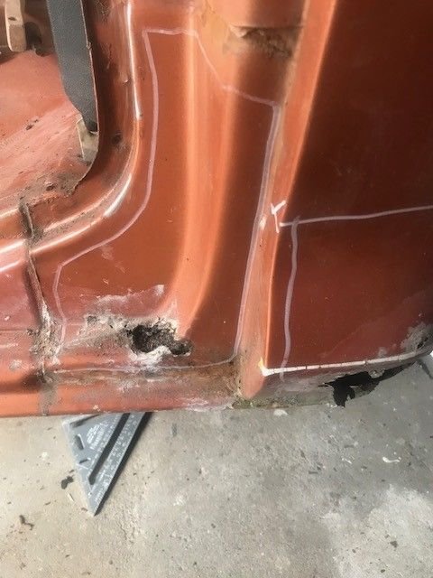

Been awhile since an update, figured i would start catching up here. Drivers door jam and cab corner needed a patch. I dont pretend to be the best welder.

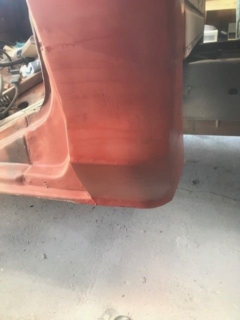

The replacement bed required a fair bit of work, especially near the tailgate hinge. Had to test out fabrication skills

Looks great.
Did you prime the insides?
I use a zinc weld through primer on the back of my patch panels
