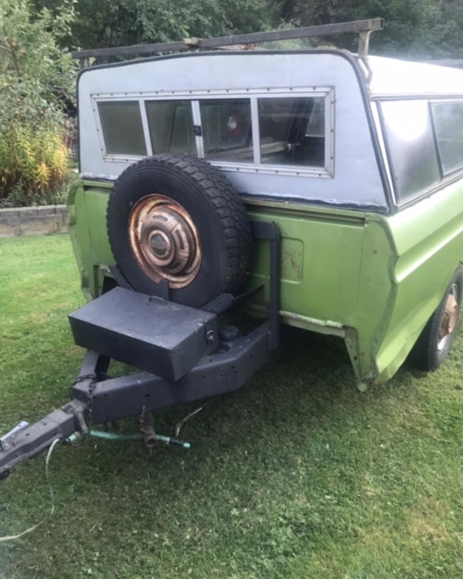

Even though I bought most of the replacement panels I had to relegate myself to admitting the obvious. It would be a better option to find a donor bed.
So after an entire 6 days I came across this one for a sweet deal. Now to find somewhere to do the swap as I only have a parkade stall to work out of.
The bed floor and cross members are solid. Its a single tank and older than my 77 but it can work. Also the bumper is in way better shape than mine.

Sweet trailer! That looks like a great bed and it even has a nice tailgate. Good find.

200$ Canadian. Will swap beds and sell as a utility trailer and maybe sell the topper separately
I'd pay that all day!
