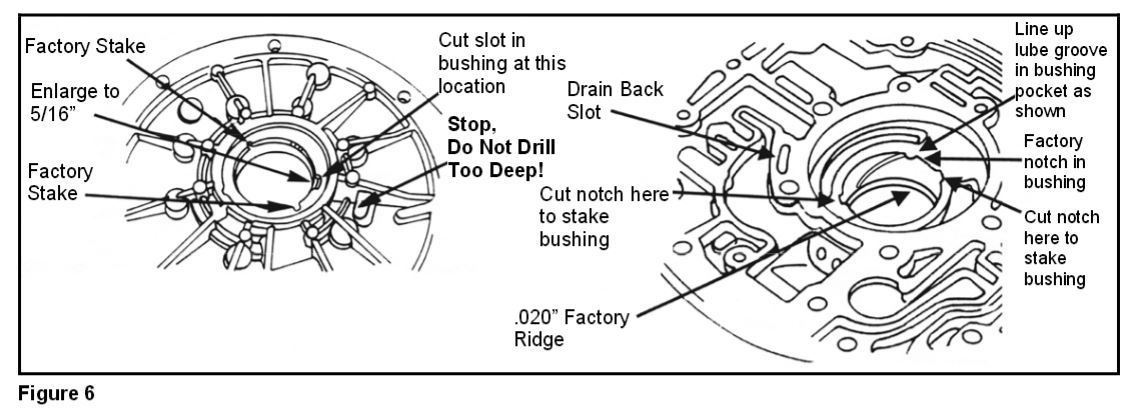

Was the trans front seal or front pump replaced recently?
Common problem is that the bushing in the front pump can cover the oil drain back, and that 'extra oil' will press out the front seal.
Tips:
- make sure bushing has drain hole in correct location, and is installed the correct way around
- install new front pump bushing
- use loctite around front seal when installed into pump housing
- use small screws to hold front seal, small holes at edge of front seal, and into pump(wish I had pictures)
E4OD busing install

WWHITE:
Thanks for the reply. No, neither has been replaced recently. The truck has been running perfectly. The bushing replacement from the pictures you sent seems complicated. I'm a reasonable mechanic and am going to pull the tranny myself but do you recommend I take it to a shop to check out what might need to be done to fix it??? Is the bushing the same as the seal? Sorry for the dumb question...

Some have been able to remove/replace the bushing without removing front pump. I had the pleasure of rebuilding the whole trans myself, first time. Yes, complicated, very step-by-step process.
Busing is different than seal.
Once you take Torque converter out, it should be obvious what the leak is from. My guess, is the seal has completely popped out.
Once you have old seal out, you can inspect the bushing. Make sure busing is located in correct place, sometimes they move in/out and or rotate. Just make sure the drain back hole is not plugged.
Bushing and seal are different.
First see if you can determine the issue, if you cannot, post back here.
