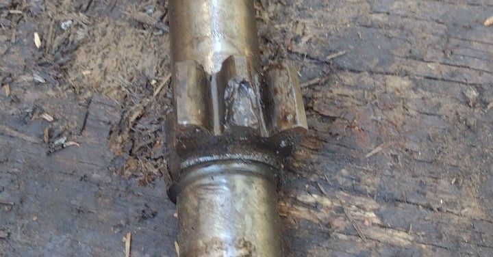

Anybody see this before?

Don't worry it's been replaced new box new pump

Wow is all I can say. Lucky it didn't bind solid on you.

Just a bad pump ended up replacing pump and gearbox.
