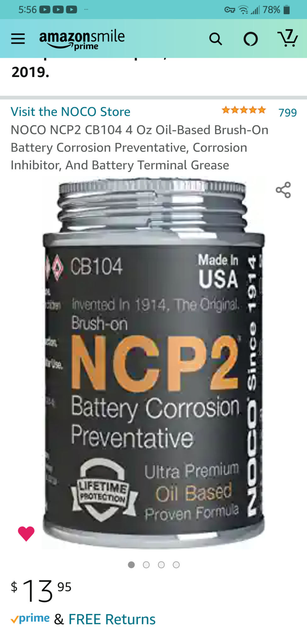

I use this stuff. Works really well.
https://smile.amazon.com/dp/B004AWO4...R9CA1QFMTDB38H
This is tenacious stuff. They sell it in a spray can as well.

It lasted about 30 days on my commercial lawn mowers before corrosion began to take over. The whip and most likely the stuff Dave posted above will outlast any other product because it is thick and gooey. The whip lasts about year on the mowers and will last the life of a battery in a vehicle. All depends on how much maintenance you want to do.
