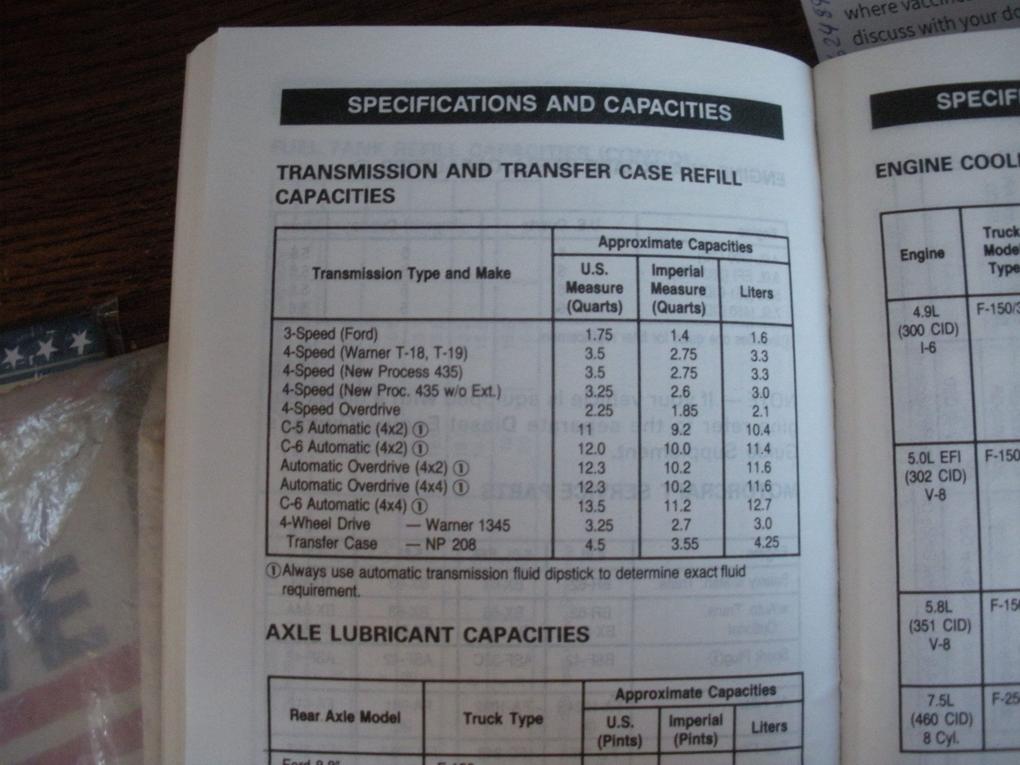

FWIW, here's from my 86 Owners manual,
That's completely drained, like when you take the drain out of the torque converter. Usually just dropping the pan, it only takes around 4 quarts.

Oh, yes, I understand that, I just was putting the info out there.
It's something I plan on doing this Spring time.
