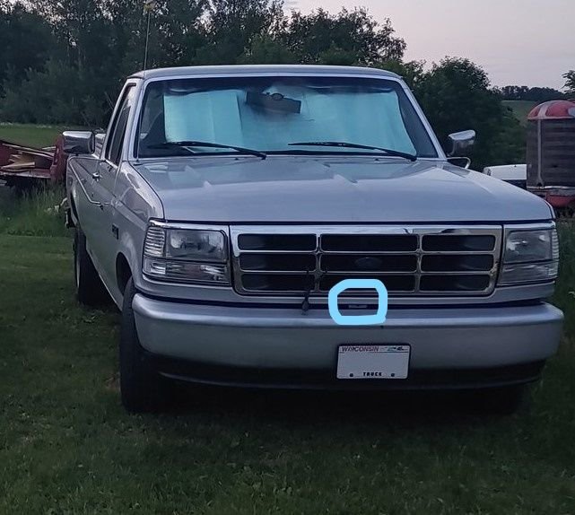

OE. Ew...if youre gonna go and replace ford headllights, buy yourself a pack of the retainer clips. all but one of mine had to be ruined to even take off and I needed a new header panel personally. but sits a lot, has been in sun, midwest. o
Cheaper housings/bezels, the plastic dimensions werent perfect so things were fitment wise a little weird but it worked. The current issue is Adjsuters, the Aftermarket adjusters are JUNk.
This was with the LEDs that came with it, cheapie, but I put nicer ones in and oriented them to have a cutoff with the cheap housing! Surprsied.
i think its been 2, 3 years now ive had em. would step up to a nicer quality kind, 90 for both was a little cheap but it HAS worked so i cant be upseet
go forder
